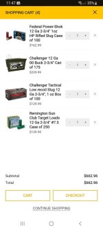

Hello all,
Looking for some advice on buying my first shotgun ammo for my first visit to the local range. I have checked different websites to compare prices, but finding that quite confusing. There is so many different elements like fps, pellet size, count, etc. Here is a bulk ammo selection from GoTenda (I think it is free shipping over $300 cad). Can you please help me select the most important ones and remove some so the total is closer to $300? Also let me know if I should be searching for a different brand, quality, etc. Or even a different website/company with free shipping.
These shells will be used for breaking in my Mossberg 590A1 (18.5" barrel) and only for target practice, zero-ing, getting used to the gun/recoil for now. Some trap maybe if my range players allow beginners with them. Screenshot_20261001-114736_Chrome.jpg

Yes it is, 12ga is a big aisle. This is what I'd do first:
175 buckshots seems like a disproportionate amount of your budget at this time? Buy 25 at ~$40, blast them and rethink what you need next.
The Challenger slugs are a perfect fit for a range day. I prefer them to Score slugs which are a similar price point. You will shoot 100 over a few trips.
The posted price on the Challengers is "fair" (for 2026). $1 or less per slug is the ideal, when you find that go all-in and stack deep.
Yes, having any brand of target load for 50 shells to muscle memory "pushpull" and "pullrack" techniques is wise.
Buy the cheapest possible (50c) and have at it. $25 well spent - shoot these first!
With the $100 remaining buy more of what you enjoyed most.

Very simply I would suggest keeping the 00 buck and the target loads.
You bought a 590a1 (very nice tactical shotgun) so you are likely thinking about some sort of personal protection. 00 buck is perfect for that. If you intend to use it for this purpose, practice with the target load until you get used to it. Then run your drills with the buckshot.
The target loads are great for practicing how the gun feels to load, point, shoot, and reload, as a first timer. They are also great for shooting clay pigeons if you have a place to do that. And generally "just for fun" shotgun shooting.
If you want to hunt deer with it, or protect from a bear, you will want some rifled slugs, but you don't need to buy 100 of them for either of those purposes. And I wouldn't suggest low recoil ones for either of those purposes. Rifled slugs are for smxoothbore shotguns like yours. Sabot slugs are for rifled Shotgun barrels (not like yours).
