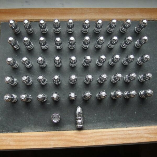

the bore diameter for Swiss rifles is most likely 10.4mm, and the bullet looks like this:
