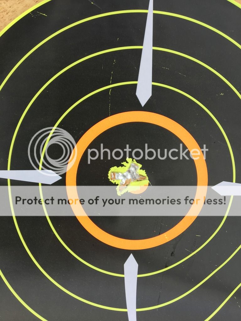

If all your rounds are key holing, I would guess the barrel is the problem. Is there anyone qualified close to you that you can take your rifle to? It's really hard to determine what is wrong from your pictures.

Well I guess it's time to slug and see if a factory load comes close to the barrel.. Cleaned her with copper solvent for 3 days tell the patches stopped taking on the blue Color and the verdict.. Still keyholing
I have to admit 2 key holing in the 10x ring is not bad shooting. I think it is your ammo now, try some 174 Grn. Remington FMJ. They most closely replicate the original MK 7 loading out of current manufactured ammunition. If they still keyhole slug your barrel and cast a lead bullet that is 2 thousands over groove diameter.

What's wrong with that, x marks the spot, right in the bullseye. I don't believe I've ever seen such precise, acurrate shooting form such and inaccurate, imprecise rifle :p Not that I'm saying it's the case here, but, I've spent days cleaning an old rifle only to switch to another cleaner, wipeout in this case and was shocked at what was left after days of scrubbing with more conventional cleaners. Some really are worth their weight in gold

Would be interesting to see a pic of a recovered bullet, if there were a way to find one.

Also, keep that target. It's very unique.
