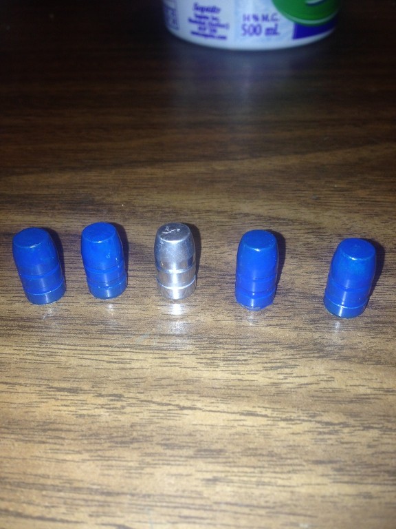

45 acp 230gn powder coat bullets.
I tried powder coating some bullets over the weekend and shot 15 rounds this evening.
6.2gn unique, 1.210 AOL.
excuse the editing in 2nd picture.
I think this is just powder left over but would like second opinion.
Top one is after 15 rounds, bottom after 1 pass with dry patch.

After doing some more reading it seems this powder isnt the best thing to use, infact it may be toxic.
The powder is TGIC based and even though this was done outside, risks seem to much.
I used info from castbullets and 300blk site but maybe should have checked out the powder before using it.
Even though its cured well I can not tell if its going to flake after shooting.
My pc experience was very short, try at your own RISK.

smash a bullet with a hammer until flat, look for flakes. from the little bit of reading i've done there was 1 colour/brand that was horrible (red or black from harbor freight) but the rest worked great.

I did the hammer test and it didnt flake, but that’s not the issue, TGIC is, as i have read toxic. Powder coat based on TGIC are banned in Europe but still powders based on tgic are legal in usa/canada.
My mistake for jumping in with out reading more in to it.

The bullets are sized to .452 (you size after coating only) but thats not an issue here, i wanted to try it out and the cost with pc coating for a lead bullet is 5 times less than any jacket bullet. The process itself is easy but the health risks are not worth any cost.
This is not new, its been done in the shooting community for many years, i guess they either accept the risk or have found non-tgic powders to work with.

how is it wasteful? the temps won't effect the bullet, if anything it will make it harder. sizing isn't any issue either.
it's the new thing in casting bullets, i suspect it will be here for a long time, but i don't think traditional lubing techniques will be tossed to the side.

it's powder coat paint for cars, metal, etc etc. not moly.
crap ton of info here, http://castboolits.gunloads.com/forumdisplay.php?184-Coatings-and-Alternatives&
I dry tumbled some Lee 358-158-RF with Harbor Freight blue and it worked real good. Loaded them over 16gr. Lil'Gun for my Rossi m92 bit have not had a chance to rey them out yet. I did shoot 10 ESPC with HF black 405gr boolits last year in my 45/70 with no signs of leading but they were just Trailboss loads iirc. Even though I have a powder coating gun, I do prefer doing the boolits with the dry tumble method. Much cleaner, as I have no powder over spray to contend with.
I tumbled these in my tumbler for 10 min, poured in to a sieve to get rid of excess powder. They then went in to a toaster oven for 10 min at 400.
The process is simple and cheap, the powder (1lb) is $20 shipped, toaster oven was $30, sieve $1
I did 100 bullets and used very little powder (some claim 2000 bullets can be done with 1lb)
I am going to try and find some non-tgic before doing any more.

I shoot 9,45,44,300 blackout cast. The main concern is leading. Powder coating is supposed to get rid of.leading issue and is also cleaner to shoot.
It's not cost much to try. I just wanted to make sure I get tgic free powder.
It's seems tgic powders are nasty, causing skin irritation and other health issues. Tgic powders are most common PC coats and are usually cheaper than tgic free powders.
