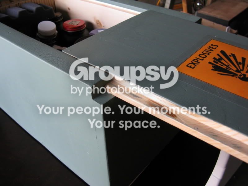

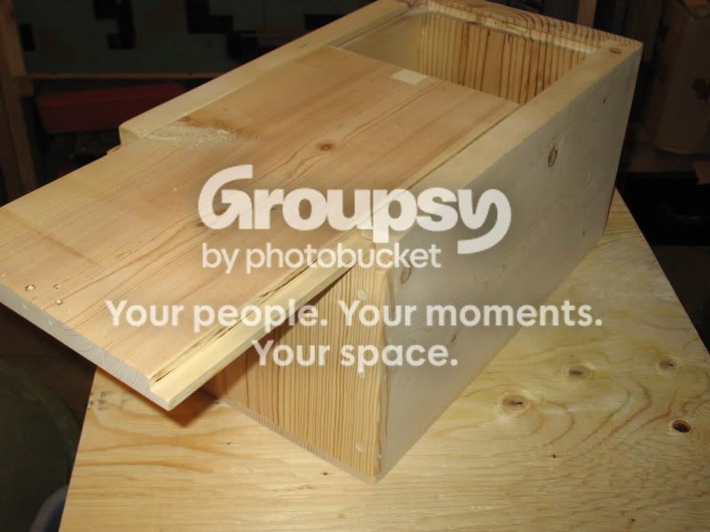

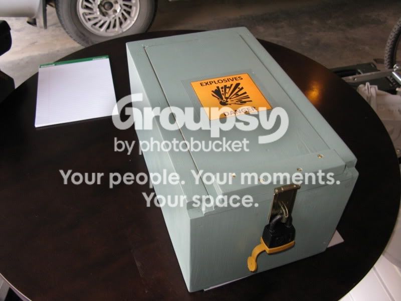

According to Explosives Act, one has to keep powder in a wooden box, 3/4" thick board or plywood and fitted with brass fixtures. 'Explosives' written on outside.
I built one for about $20.
