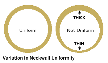

Trevor mentioned that neck turning may not be worth the time and effort for some. I don't really think its time and effort as much as it is the acquisition of suitable hardware.
I've gone to considerable lengths over the years having components made that I could not purchase in the quality and accuracy I expected.
Now that I have what I want, I turn necks very quickly and its a low effort process for me anyway.
I would suggest that anyone considering neck turning for large quantities to focus on ways to use power tools and not the little T handle gizmo we usually get thrown into a neck turning kit. The T handle is fine for a few cases, but will wear you down over hundreds.
If there is a downside to neck turning, its really just your time, but I see it as beneficial even in the worst case where the rifle has a sloppy chamber. Again, this is in the scope of F Class and other high precision games.
You may not see that it helps you (even if it does in the aggregate), but it wont hurt you if you only do a minimal clean up. At least your neck tension will be more stable... And lots of guys feel neck tension is critical to low SDs...
Sure lots of guys don't think neck tension matters at all, but I have no faith in a man who clings to the lowest possible rung on the ladder and looks for ways to justify his resistance to climbing higher. That belief can be classically defined as unconscious incompetence.
