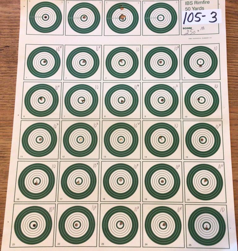

2500x with a Shillen ratchet is where I’m at. In our game we have 20 minutes to shoot at 25 X dots that are .095” in diameter.
Once I get beyond 50 or so rounds I can definitely tell that my POI is starting to wonder around enough that I won’t take a chance and not clean it.

Before putting Precision in quotations you should actually shoot a PRS match. I think you'd be surprised at the level of precision required, specifically precision that can't be bought since it comes as much from the shooter as the rifle.
We've been shooting matches that give you 30 min for 25 shots. The target we've been using is the IBS target which has a 10 ring of .500" and the X dot I'm not sure the exact size but the the 1/8th target dot on my t36 just covers it. Which target are you using? Is it the USBR or IR50/50?
Our ranges dont even have the facilities to be able to clean between targets. I would love to just see concrete benches instead of wooden ones at our ranges as you have to be very careful how you touch the bench as you can see the reticle move with different pressures.

I would never look down on any other shooting discipline.
I currently and in the past have shot IPSC, F Class, SRBR, BR for score at both short and mid range and of course RFBR. I haven't competed in silhouette or in any type of RF PRS matches but have done both for fun over the years. Just not at a formal match.
All of the above has taught me that you cant buy anything. You want to win/compete in any discipline you have to earn it.
250-18x is one of my best targets to date, your comments suggest I simply bought this? You have no clue.
IBS, and I missed typed when I said 20 minutes, we have 30 minutes. The range in Kenora where these matches are held have both concrete and wood benches. Both are excellent.
My best score so far on the IBS target is 500 and 29x over a 2 target match. That was shot with a 40x with a factory barrel. It has been bedded and has a jewel trigger. Been using centerX .
