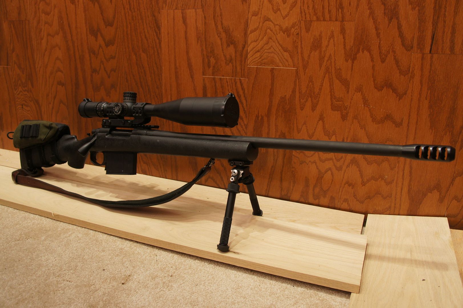

Kevin, if you don't mind sharing who did the work?
Trued rem 700, Timny trigger, defiance machine DBM, AI mags, Krieger 1.25" barrel, custom brake, A5 stock
not picture is the 5-25x56 SB w/ H59 retical
This picture made my pants move...
What's the caliber? Got a range report?
Very nice rig!
It' would be .308win , no range report yet :/. Works been all over the place and I haven't been able to find enough free time at once to get out and shoot .
Ohhhhhh... my goodness.... This rifle is so sweet now...
The brake is insane! Virtually no recoil, I swear an AR-15 has an equal amount of felt recoil... and that is with hot 300SMK loads too! The shooter gets no blast whatsoever, it is not distracting, and does not kick up any dust or dirt. According to my buddy beside me, it is not much worse than the old brake to shoot beside either, which surprised me.
Quite happy with the accuracy of the bedding too, need to do a bit more testing on the hottest two loads, hard to tell if it was the wind, the snow, or me, that pushed the two shots off by an inch, but still, some of the closest overall groups I have ever gotten with this gun.
The Rem is looking good! Love that brake!

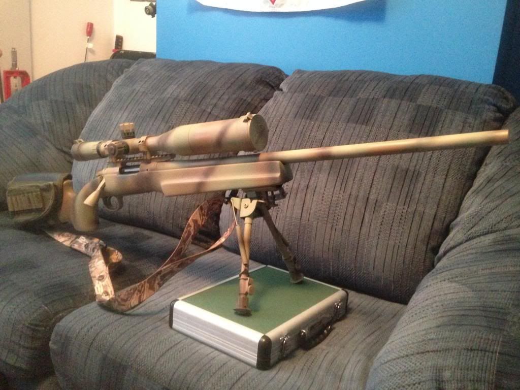

My practice rifle 700 AAC-SD, Bushnell Tactical Elite 6-24x50, ATRS 20MOA scope rail, KRG Bolt knob and Harris 6-9 bi pod.
Cheap and fun to practice on
