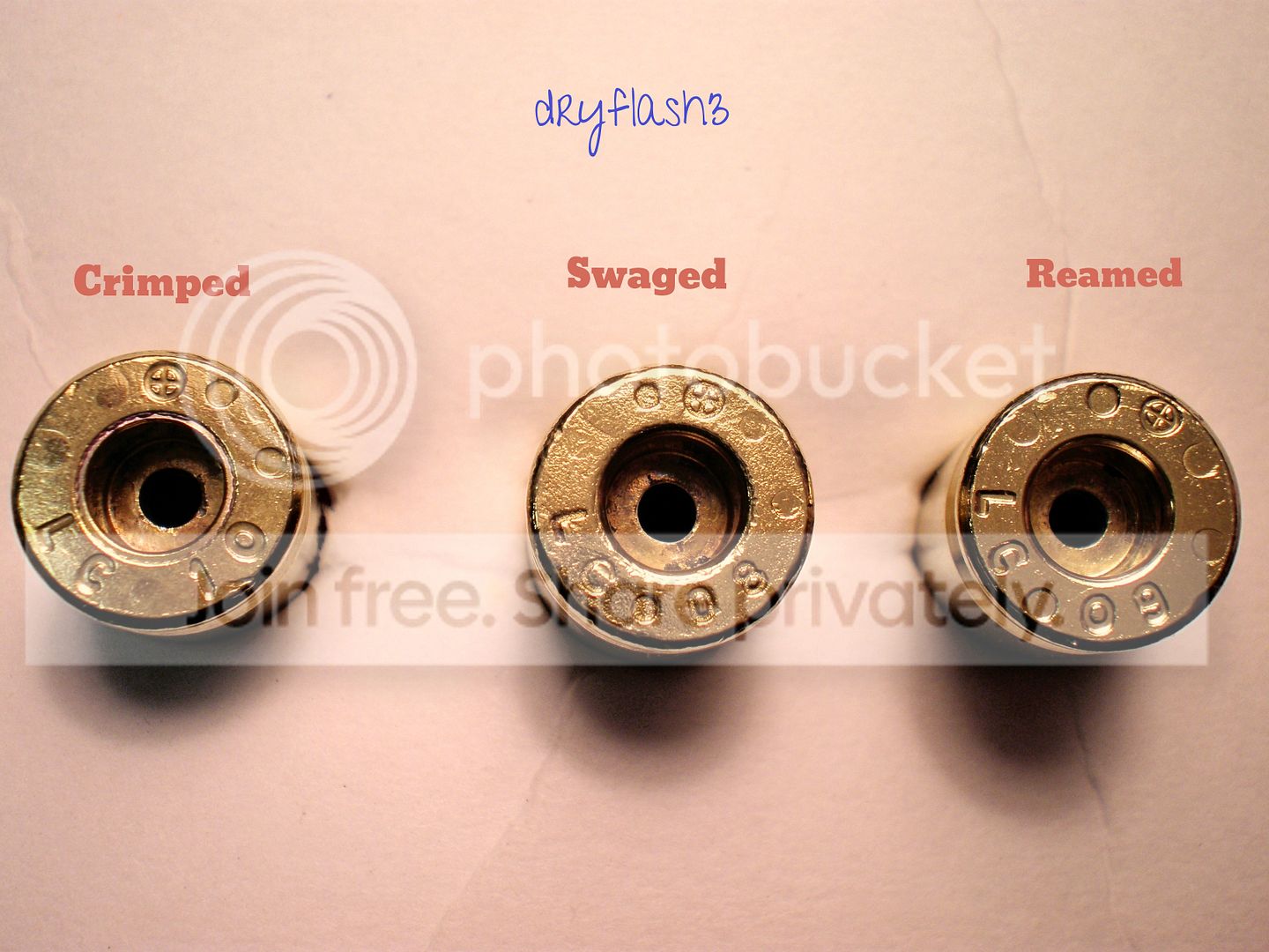

For the uninitiated (as was I) here is what primer pocket crimping looks like:

Yep, that's it. Here's a pic of the decapped brass:
[/URL][/IMG]
I just used a press mounted swager (RCBS) and they're all good to accept a new primer now.:d
