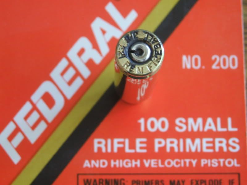

you will most likely find this :
small primers
I have used small rifle primers in my 357 but would;nt dare use small pistol in a 223 . think about it . from what I have read you should;nt use large rifle primers in a large pistol as from what buddy said they sit higher in the pocket than large pistol . and so the article said small pistol and small rifle are the same size just not the same strength. :runaway:
