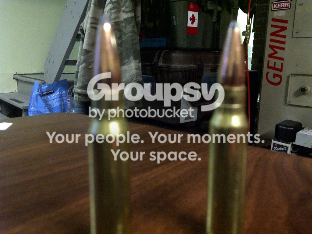

I am fairly new to reloading but I have pumped out a couple hundred rounds so far with no problem until today. I neck sized some brass from my Gunsite scout cleaned it all up and so on. When I attempted to put the round together ( using hornady .308 die and hornady 165gr interlock soft points) the die shaved a ring of brass off about 1/4 inch down from the top of the neck. I never had this happen so I made another round same thing. After this I decided to make a dummy round and try to chamber it, It was a little ruff going in and then it would not come out I had to push it out with a cleaning rod. Any one know why my die is doing this

It is actually pretty obvious what has happened. You only sized 1/2 your neck when neck sizing, then when you run the case into the seater die, the neck aligning portion in the upper die is smaller diameter than the fired neck size of your case. Hence the shaving. You can solve this easily by sizing the full length of the neck. I have run into this when making 7X57 from 280 Rem brass, different reason but same effect. My 7X57 neck used some of the heavier brass in the 280 shoulder area, giving me a 2 diameter neck. Thin at the mouth but too thick at the shoulder. Had to turn the back half of the necks. In your case you just need to size more of your neck and all will be well.
