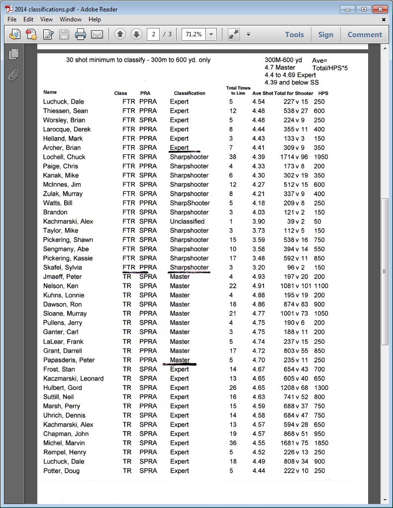

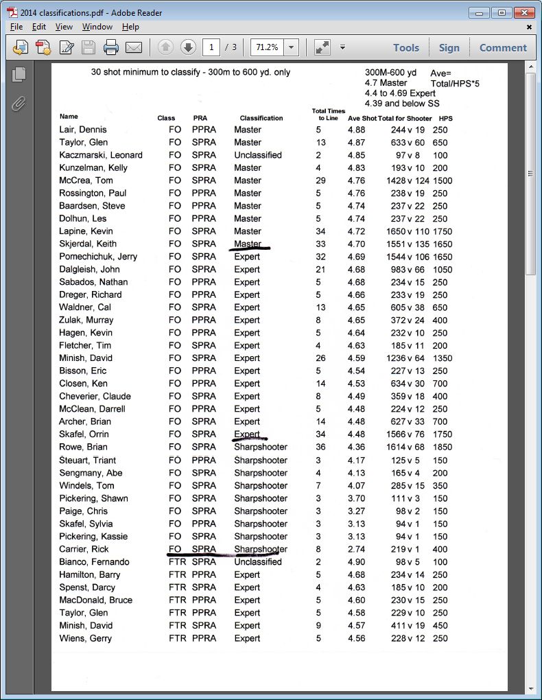

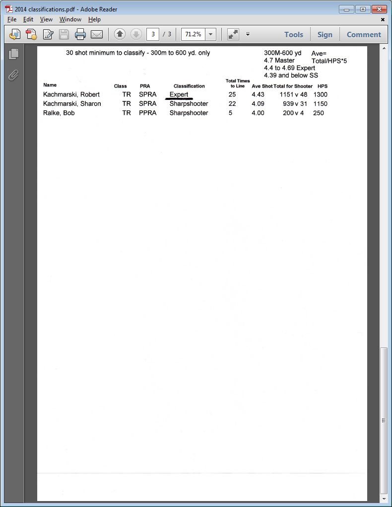

Duplicated the classification script and called it FClass Classification to include all yardages and ran it for you too. Came up with a total of 375 out of 400 for you which works out to an Expert score of 4.6875. Only have 8 scores in the database for you from a PPRA back in 2011.
Next I ran it for GT and he shows 1442 out of a total possible of 1525 for 34 scores fired at Northstar from 2011, and this makes him an Master in FO only with a 4.72786885, and he too is a Master in the US. Original run included some of his FTR scores. Now that too makes a difference, including these made GT an Expert in both FO and FTR combined, using just FTR he comes out a Shartshooter in this time period.
This also shows that all classification systems are an estimate of the shooters ability and not perfect and the breakdown need to be different for FO vs FTR.
Using all scores, Paul comes out an Expert with a 4.525 average and this is were he should probably be, and I too come out an Expert and maybe this is were I should really be, an Expert in FO in Canada, firing pairs :)
Your results using ALL distances make a lot more sense and the results "fit" with how I would rank them intuitively. I would have to agree with my ranking as Expert, it's the same as my NRA ranking for Long Range.
Ok, using my newest system based on comments and recommendations here (shots > 60, since 2011, all yardages included, all matches included)
Here are my results...

Note: on days that GT shows up shooting FO, all us FO Experts bump to Master and on days that Barry H and/or Bill W show up shooting FTR, all the FTR Sharpshooter's bump to Expert so a prize can be allowed to the top class shooters as well.
and again, using only 300M to 600 yds and the one the SPRA will probably use;

My intent is to make this work at our PRA level, and if the others PRAs want to use the system we adopt, they may. From a national level this would be up to the DCRA Fclass committee, which I too I'm a member of. This committee can bring forward any recommendations to the DCRA for a National system. My guess is this may take a year or two and ours will be the test ground. I will also guess that our exec will opt for the 300M to 600 yds version since this allows more shooters per class breakdown and less of a chance that everyone is pushed to the Master class.
I'd like to thank you all for your input and suggestions and in time, we may end up with a FClass classification system that will work. Now it is up to the SPRA exec to pick the system and implement it.
Keith, looks like you're putting alot of time and effort into this!!! I think its a great idea...keep up the good work!!!
Question for yah, in a case like mine...where i shot FO in'12, FTR in '13 and am going back to FO in'14 would my classification be the same or would i be classified in both? Just curious how you'll do it?
Well I re-ran it for you and in FTR and FO you are an Expert :)
If you had not shoot in say FO but only FTR, your are not a Greenshot (only for first year shooters) and your FTR classification would still put you in an Expert classification in FO. Same with the other way around, if you started in FO and switched to FTR, I would still put you in the Expert class in FTR and if your scores over time were bad enough, you would slip into SharpShooter.
As you can see, using all yardages and just the 300M to 600 yds ones, you are a little higher in the averages in FO, due to better equipment and higher in the all yardage averages in FTR due to a heavier bullet and more experience. FTR was a 308 and FO was a 6.5 for those interested.

Ok I did more work and added all the Westerns into the PRA mix (total of 4425 scores from 164 shooter for 300 to 1000) and this is what I get using all yardage scores and not looking at FO/FTR breakdowns - if you are a cross shooter LOL
48 shooters in total shown below here and there is pretty good division, but that would have to be at a big match, like the WCFCC or the Cdn FC Nat in Ottawa
SGaa 4.7666 Master
MThib 4.7412 Master
LDolhun 4.7225 Master
GOgg 4.7113 Master Note: using his 2008 CFRC scores :)
RDreg 4.7 Master
EBisson 4.6873 Expert
RWyen 4.6833 Expert
JDalg 4.6743 Expert
KSkj 4.6684 Expert
NSab 4.6656 Expert
SBaardsen 4.6633 Expert
BCondie 4.658 Expert
GTaylor 4.6394 Expert
TMcCrea 4.6366 Expert
DLair 4.6125 Expert
CWal 4.6113 Expert
BHam 4.5938 Expert
GWiens 4.5718 Expert
JWilder 4.5667 Expert
PRoss 4.5656 Expert
KLepine 4.5497 Expert
BWors 4.5422 Expert
JPom 4.536 Expert
DHarry 4.5153 Expert
KKunz 4.513 Expert
LKacz 4.5072 Expert
DSpenst 4.5035 Expert
JTeo 4.4793 Expert
TFripp 4.4769 Expert
KClosen 4.4543 Expert
DMinish 4.4416 Expert
SThie 4.4406 Expert
MYoung 4.3833 Sharpshooter
BHarmes 4.3793 Sharpshooter
DTomlin 4.375 Sharpshooter
NDoan 4.3351 Sharpshooter
CChev 4.3343 Sharpshooter
CCauce 4.3051 Sharpshooter
BRowe 4.2891 Sharpshooter
BArch 4.2672 Sharpshooter
OSkaf 4.2532 Sharpshooter
RMoroz 4.2041 Sharpshooter
CLoch 4.1589 Sharpshooter
JMcIn 3.9854 Sharpshooter
GBeer 3.7111 Sharpshooter
CPage 3.5764 Sharpshooter
SPick 3.555 Sharpshooter
CRick 3.2454 Sharpshooter
I did some checking and found you can not add 10 bull and 5 bull targets in calcs, it inflates the results!!
Using Les D as my test subject, I found this out. Could not figure how he was so high, sorry Les.
Original calc was 3353 points out of a total of 3550 so (3353/3550*5) =4.722535
Calc'd just the 5V ave at 4.514 (948/1050*5)
Next calc'd just the 10X target ave at 4.814 (2311/2400*5)
Then using a spreadsheet and reducing the 150 max (10v) back to 75 max (5v), his average for these two WCFCC matches were the 10X target was used drops back to 4.629 on a 5V target (89 points dropped in the sixteen 15 shot matches, so 1111/1200*5). Taking an average of these two his average comes out at 4.571
This means all of the last post figures are inflated if they shot in the last two WCFCC matches and most of us using all scores reduced back to a 5v target would be in Expert class once again, some lowered to SS.
Another way to look at the difference, think of dropping 5 points on each type of target, 70/75=93.3% and 145/150=96.6%! So even % do not solve this and why the US percentages have to be higher, plus they shot string!
INTERESTING eh! BLOODY MATH rrrrrrrr
Good thing I have saved copies with these separate still and have since corrected this issue, now both are working as they should. After re-running the westerns classifications again, which ios based on only the westerns from 300m to 1000 yds, we are again left with 1 FO Master, 17 FO Experts, 25 SharpShooters and in FTR, 0 Masters, 2 Experts, and 40 Sharpshooters out of the 85 shooters in from 2010-2013. Again, the MR system would allow the best breakdowns in this country IMO.
BTW, the guys in the highest class in the Western version for both FO(Master) and FTR(Expert) only shot once in 2010 and if they attended more Western's, they too would be in lower classes IMO.
THe SPRA executive in the Dec 1 , 2013 budget meeting has approved FClass classifications using mid range scores system (300m to 600 yds) so we have both classifications and larger possible numbers in each classification for our local matches, with awards for each class and classification.
