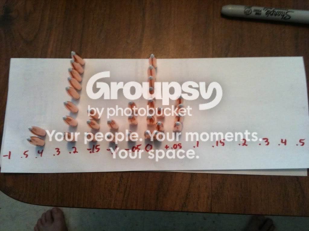

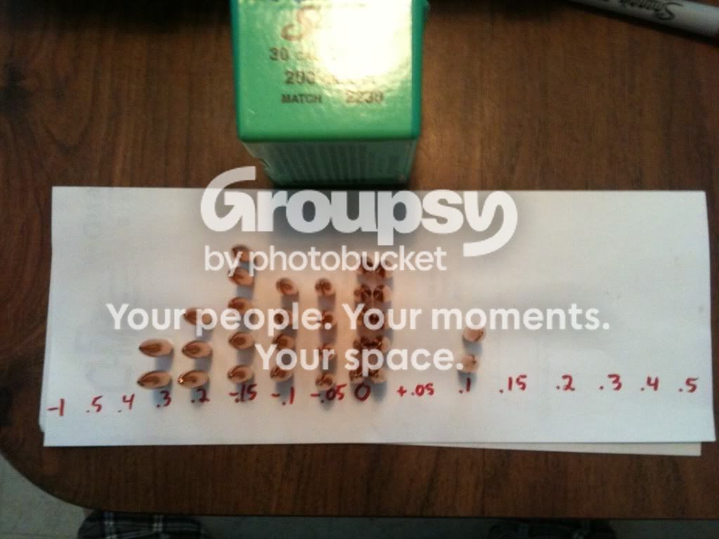

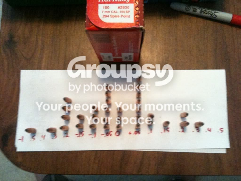

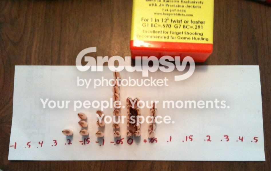

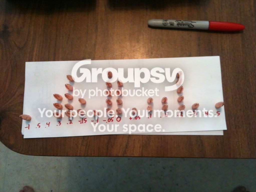

Here are a few pics of a little check I did a few months back. The first four are all 30 cal. Each sample was taken from the same box just as they were purchased. You can see the manufacturers that mix production lines. The accubond and tsx have separate "nodes" that the bullets weigh, showing separate production lines mixed in the same box. The berger VLD are run off a single line per box to tighten tolerances. I don't think that match bullets are built to any better tolerances, only that the manufacturer does not mix production lots.
190gr VLD
130gr TSX
165gr accubond
200gr Sierra
7mm 154gr hornady SP
