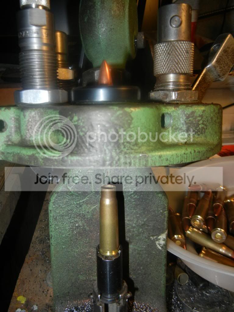

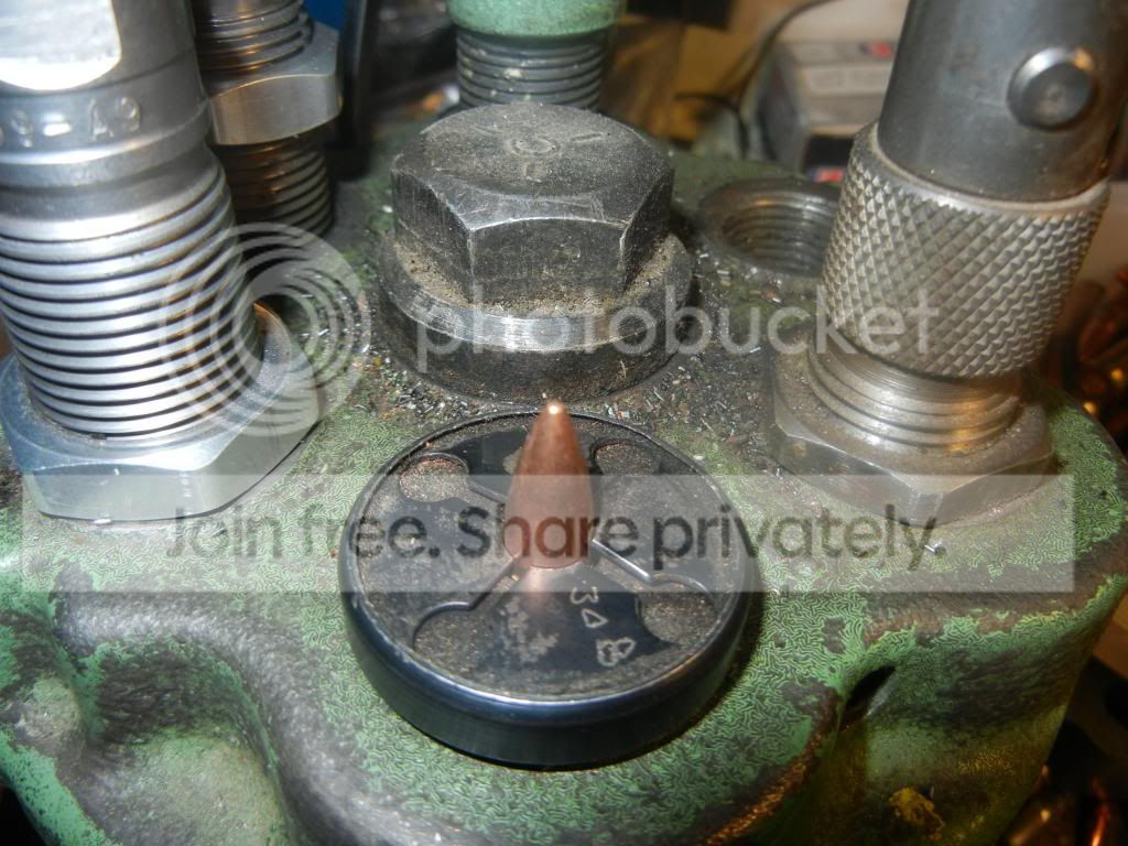

I use one of these. Bullet is pulled on the down stroke. next round pops the pulled bullet out the top. Can pull 1 round every 5 seconds.
Nice set up , I do something similar but with the cutting edge of line mans pliers , I see someone else has some of that brass cased romanian surplus , I have a case , nice stuff if you can find it . The pliers trick does leave a couple small marks on the bullet but if am mostly using them for plinking and offhand practice so I doubt it makes a difference
