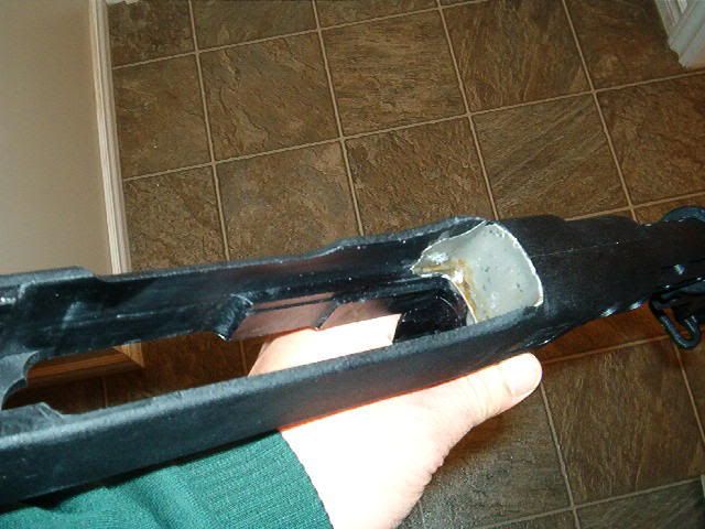

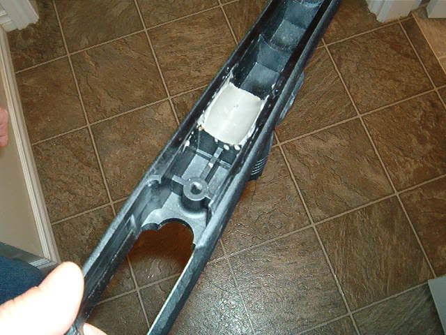

Jerry...could you post some pics of the bedding and some instructions? I've never bedded an action.:redface:
There is lots more info in the 10/22 sticky at the top of the forum but here are pics of the Tapco bedded.
You rough up the rear area. I used a Dremel and some carbide bits. The part under the barrel is partially filled with whatever solid material you have on hand. Glue in with epoxy/bedding compound.
Lots of release agent on the action. Put some bedding compound on the two areas. Assemble. Let cure. Pull apart and hopefully this is what you see.
Jerry
