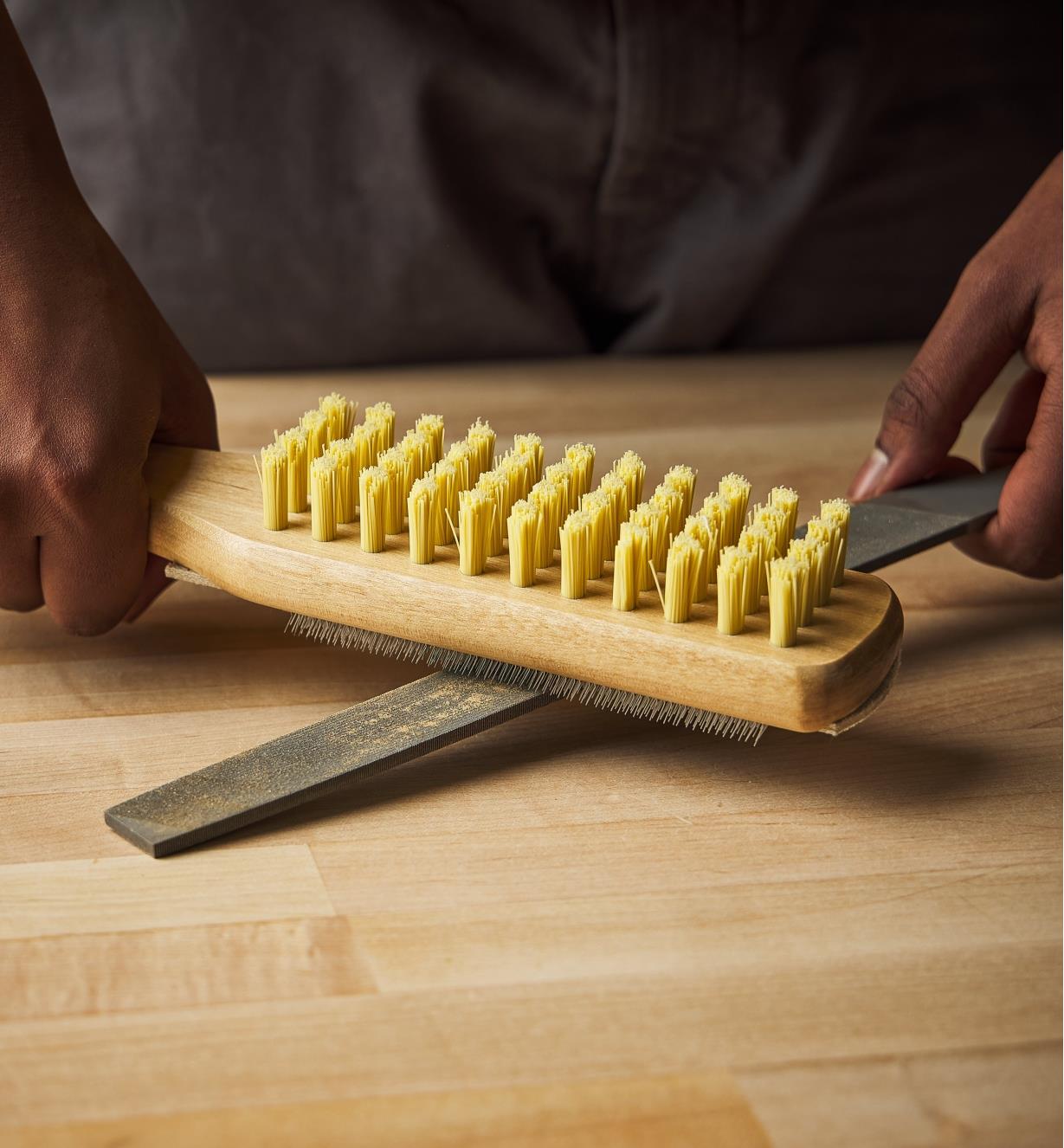

I believe Lee Valley carries them, but you have to order from their website.
Lee valley does carry them - I have one. The nice thing is the brush on one side - they call it a file cleaner.

I don't know why they even bother with the wire side - it doesn't work anyway.... I peeled the leather holding the wires off mine... keeps me from temptation ;)
Yes, I never use the wire side anymore. I mostly use a scrap of hardwood to scrape the teeth. Occasionally have to grab the brass scraper to get a stubborn pin.
