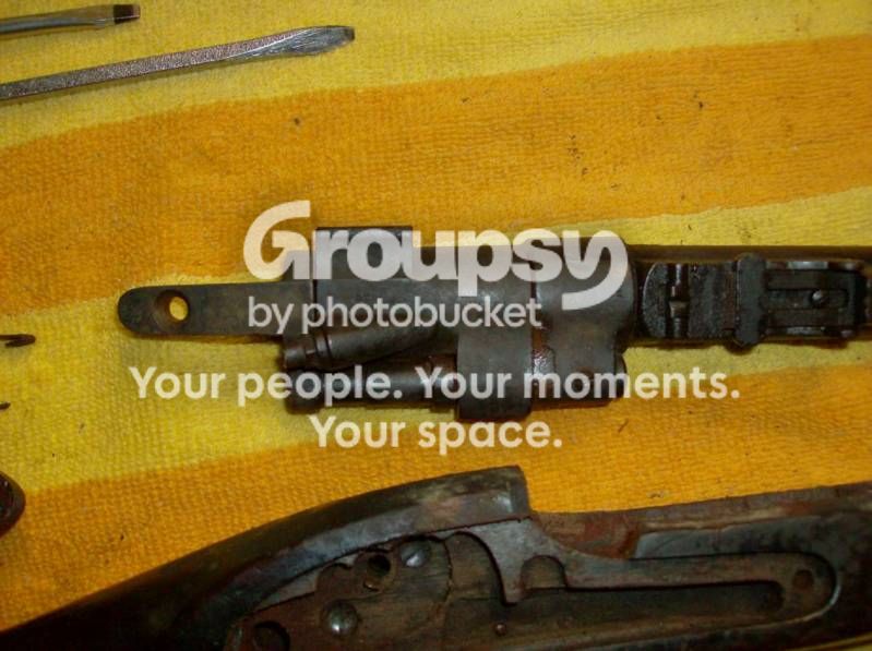

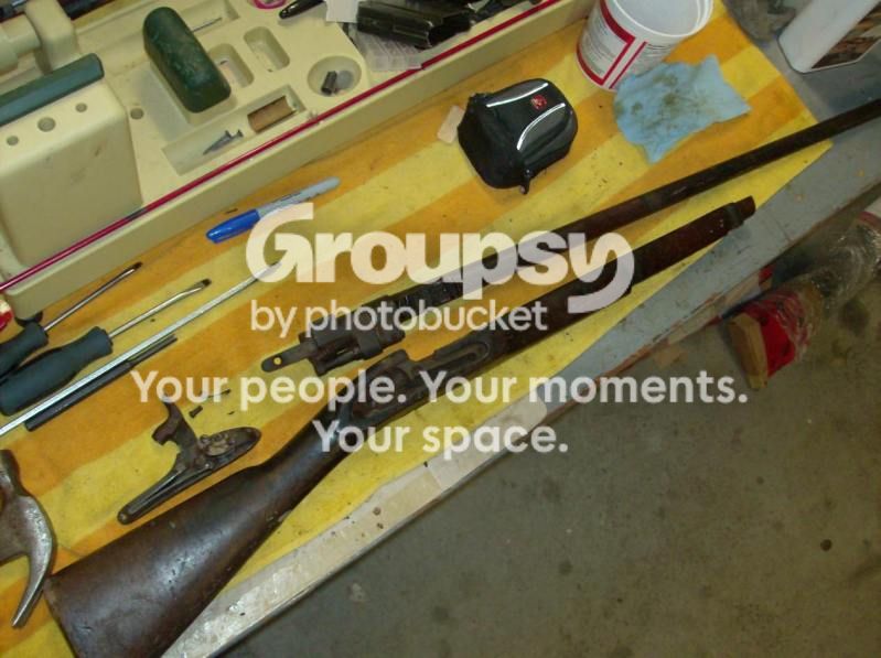

First antique to make its way into my shop; took it apart this evening and I think I'm not missing too many parts. I'm definitely not in my familiar territory so I hope you don't mind me asking questions...
1. What do I have? How bubba'ed or original is it?
As far as I can tell, it's an 1862 Snider-Enfield (on the side of the lock I can read "1862 Enfield"). I am not sure if the stock was shortened; there were two bands holding the barrel in the stock. There is no butt plate on the stock. One spring is broken (cocking spring?) and the trigger guard is missing. The barrel measures about 35 1/2 inches.
2. My hopes are to turn this into a decent wall hanger, which could #### and click; where could I find a replacement for the broken spring? And a trigger guard / screws? Thanks for any help, tip, info, etc... :)

Hi, Louthepou: I may be wrong, but looks to me like a standard Snider Enfield Long (originally 3 band, shortened to 2), in .577 caliber. You can porbably find parts (butt plate, etc) at NUMRICH Gun parts, out of the US. A restored good condition gun can go for about $500 to $900. FYI.

Yes it has been sportered, they can be reloaded with 24 gauge shotgun brass and are alot of fun to shoot!
Another place to look for parts is IMA in the states
Cheers, McLean
the broken spring is called a sear spring (puts tension on the sear to ensure that it goes into the half #### and full #### notches). Not that hard to make and can be forged out of drill rod. You mention that you have a shop of some kind; machine shop or gun store type shop?
original barrel lengths were 39" for a 3 band and 33" for a 2 band and 24" for a carbine
cheers mooncoon
Looks like it is definitely a Mark II, but I can't see a Star.
Mark II had the new-model Extractor.
Lou, you like to retrofit Lee-Enfields. We all know that; it's in your sig line. This thing is just a Lee-Enfield's great-great grandfather. You can do it and make it look good.
Forget about a wall-hanger: Sniders are absolutely the most FUN of anything I know just to take out and waste some powder.
You look to be missing a firing-pin. If you're missing that, you might be lucky but you might also be missing the spring for it. Firing-pins can be made from a nail, given that you have a small lathe and a few minutes to play with it.
The LOCK disassembles very easily, but you NEED a Mainspring Vise to do it. Anything else is just begging for a broken Mainspring..... and they are few and far between and the replacements often don't fit worth beans.
You need another band for the front. The bands are all different sizes, so you need a Front Band for a Snider, Snider-Enfied or for an 1858 Enfield muzzleloader: all the same part. The bobbed Fore-end you are entirely competent to make: we have all seen your work.

By any chance is BSA stamped on the breech block and a Mk11*on the receiver?
I scrubbed some rust and grime and - well I believe that's what's stamped on it. Have you been in my garage during my absence? :D Actually there are two stars.
I also removed the nipple (chipped, not my doing), and freed the broken firing pin and broken firing pin spring.
