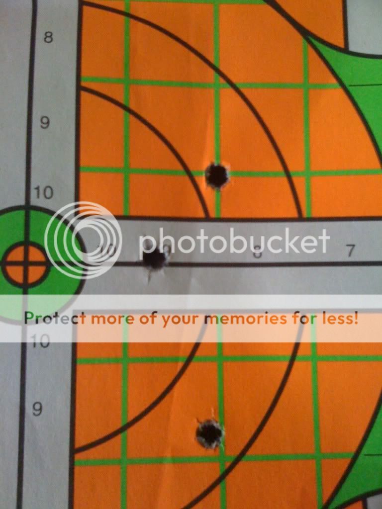

Took my Accumark out to the range today to test her out with the new Leupold scope and results were not too bad considering how windy it was.
I only had factory ammo with me. One box of 180gr Ballistic Tip and the other was 180gr Accubonds.
Here is what the Ballistic Tips did @ 100yds

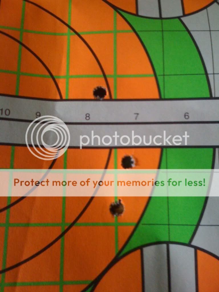

Here is the Accubonds...

The horizontal spread looks good,but the vertical stringing is a bit much.Were those the only two groups that you fired?
I fired four groups of 3 in total. The other groups where fired at 25yds to get on paper after bore sighting. I am going to check the action screws and make sure they are torqued to the right amount. I made sure to allow the barrel to cool down between the two groups. I just wanted to get it on paper and see how she handled.

Chek to see that you've got clearance between the barrel and forend then consider bedding it to try to tighten up the groups.
That's a downfall of the super 30s...you can torch a barrel before you find a load that works right. But that's the price you pay to shoot the fastest 30 cal out there (with the exception of Lazzeroni's big 30, but at that point it's a question of degrees)
Yes, those BT would be like using varmint bullets on big game. I will not be using them other than to get the brass and shoot some paper :)
I was always under the impression that Weatherbys had a forearm pressure point. Will check all the screws and try some reloads, but if the vertical stringing continues I will pay a visit to Rick at ATF for a bedding job.

Be doing good to get a 12" group at 500 yards with that load.....I'm sure it will shoot with the right load.
What did the other groups look like?
That's all I fired at 100yds. Putting together a load with Retumbo and 200gr AB and also with the 180gr Partition. It will shoot much better with reloads and maybe a different type/weight of bullet.
Reason I ask is the vertical is about the same....Could be a coincidence or may be a scope or some type of mechanical problem??
