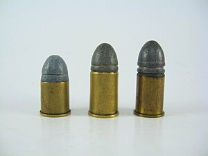

I have been toying with the idea for an antique. The thought was to put a step in the case, put in the powder, a card wad then shot and a card wad, seal with carpenters glue.
The issue I see now though is that the gun is black powder only, since it needs some compression I am concerned about the BP not being compressed enough if I run a rod through the neck rather than a full diameter compression that I use for seating bullets.
I also have the option of just making a case that runs up to the step in the cylinder then seating a card wad, shot, card wad and glue but the amount of shot is only about 50 grains in that case or about 40 #7 1/2 shot. I was thinking of buying a box of 12ga skeet loads with #9 shot to cannibalize but want to prove the concept first.
