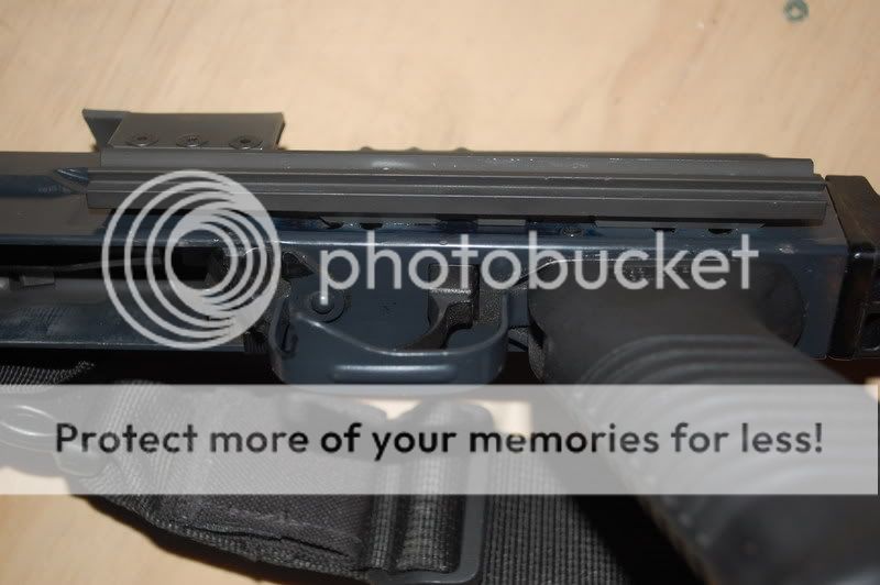

I don't see how or why you can't post complete pics
of a product that is up for sale.
The real reason I asked you to post detailed pictures is simple,
I would like to see in the same picture if possible:
the mount of your choice while centering some scope rings
(or picatinny rail) above the bore
AND the rail sitting on the receiver without shims,
that is, people may want to see continuous material
from the left side of the rail up to the receiver.
Oh yeah, and without faking it by holding the rail in the desired position
by hand, clamps or whatever and cropping the pics after
Please remember, these two details on the same picture.
Can you please post that COMPLETE picture? Thank you.
That would eliminate many doubts surrounding your claims
about the centering of that mount and
it will convince me and other people here.
If you have a rail that does what you claim,
posting a pic like that would be a piece of cake.
Thanks again.

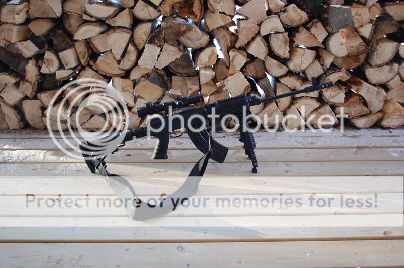

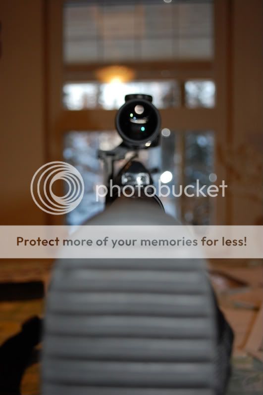

Here are some pics of one of our test rifles with a Bushnell 4200 Elite 1.25-4x30 IR scope mounted center over the bore. If anything this is the setup I recomend most but the scope is almost as much $ as the rifle so if you want to spend less then the 4x24 POSP is very good as well for 1/4 the price but is offset and a bit heavier.
An aimpoint using this mount would be pretty slick too.

I have already posted two pics of mounts centered without shim.
You posted mounts centered, yes, but I find it hard to believe
there is no shim between the rail and receiver.
Let me see the mount centered AND no shim on the same pic.
Closeups of the rail will be posted online too. I'm not going to give details of construction away one the net, I think thats fair and we've already shown more then most manufacturers do.
I didn’t ask for “details of construction”.
When I asked for “closeups”
I was actually referring to close-ups of the setup,
like mount assembled on the rail
and general fit of the setup on the rifle. Nothing else.

Wow I never thought I would say this but I actually shot till I was tired of shooting! Good working weekend though ;) .
Another day at the office? I wish, but a solid day none the less:
I'll start with some glory shots then get into the technical.
The weather was cold (-10 to -15) but otherwise great. Nice sunny clear days with no wind.
The 100m rest:
The tree that was holding up my target lol. I never thought I would see this but I did:
Over 200 rounds fired at this one, about 150 with the barrel too hot to touch using Czech surplus, 75-100m, mostly unsupported and a lot of rapid fire. There is a lot of drift with that ammo and a hot barrel. 40 rounds of Norinco silver box. The best Czech groupings were about 4" @ 100m and the Norinco ammo did much better with my best grouping at 1.7 MOA off the bipod on a rock :D. I'm sure a better shooter sand bagged would do much better.
One more shot that I like:
Now for the goods. I mounted up multiple mounts/optics and all worked for me who is a lefty but as always YMMV. I'll give the optic name and mount name with a side view and rear view to show relation to the bore:
Firstly the rail itself mounted. (Note: this deflector is not exactly what the final version will look like as this was the basis for our testing. I will post up pics of the final version when they are ready)
This is a good time to clarify something. We designed the rail to mount in a variety of heights inside the lightning cut, you have about 3/8 of up/down play to work with. Depending on the mount or optic you choose different heights can work better then others. I will include how to choose what is best for you in the instructions that will accompany the rail as it can be confusing without having the rail and optic/mount in your hands.
For Lector a pic of the mating surfaces without a shim, you will have to take our word that all the pics are of this setup :nest: :
Rail with the PK01 mount and 30mm optic from the mount side:
Other side:
And centered:
The scope is a 1.25-4x30 Bushnell 4200 Elite, it has a 30mm tube. For me this is my favorite setup, mostly cause I'm left handed. There is room for a 40mm bell for sure if you want a larger aperture. Also there are ring reducers available so you can run an optic with a 1" tube, this is what John runs on his.
