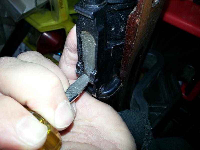

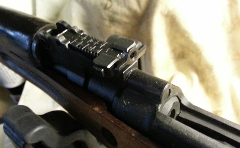

No problem ... installation is pretty easy, especially if the rear sight has been removed in favour of a rail some time before.
I have a few cell phone pics of some of the installation if folks feel that would be useful.
I was going to wait for some professional pics as I figured the installation was dead easy, but if people feel differently just let me know.

3. Install the peep sight assembly.
Depress the forward end of the sight spring with the Robertson screwdriver. Place the peep sight on the sight base making sure it is aligned properly. Maintain steady pressure on the spring while tapping the back of the peep sight with the mallet. Once the sight contacts the screwdriver, remove the screwdriver and tap the sight home with the mallet.
You are done. The sight may be adjusted for elevation by squeezing the slider and releasing when the desired elevation is reached, just like the original SKS sight. The front sight can also be adjusted if necessary.

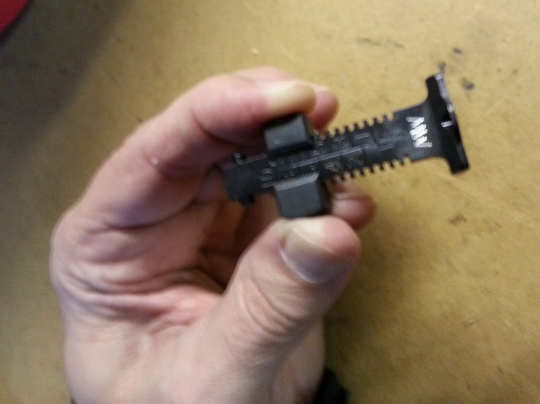

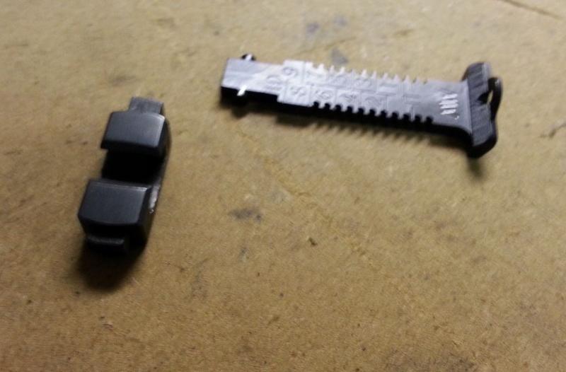

piece on the left is salvaged from your original sight, piece on the right is what you get
here the two pieces are shown assembled together
again sorry for the poor image quality
