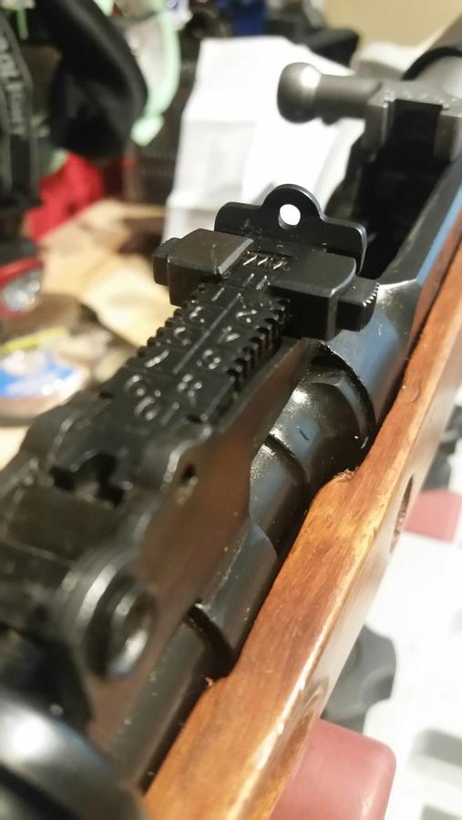

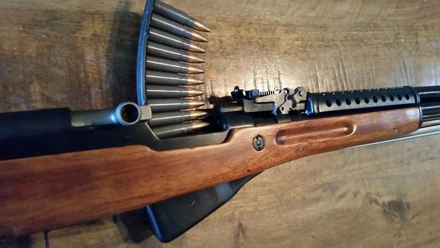

I just installed the Raveneye rear sight in my SKS,
Was wondering if anyone had any issues with the "under-site-tongue-spring" not putting any pressure on the new Raveneye sight?
I installed it, and removed it to check, then re-installed it. It is properly installed, the pins are sitting properly in the holes (side holes), it went in the guide channel properly and looks properly mounted, BUT
The spring no longer has any pressure on the Raveneye piece, the raveneye is just there, it doesnt spring down, you can lift it back and forth, and it wont "snap" back down, its kinda just binding at whatever height you set it to.
Im going to oil the pin holes and spring,
Anyone else have this issue?
Thanks!
