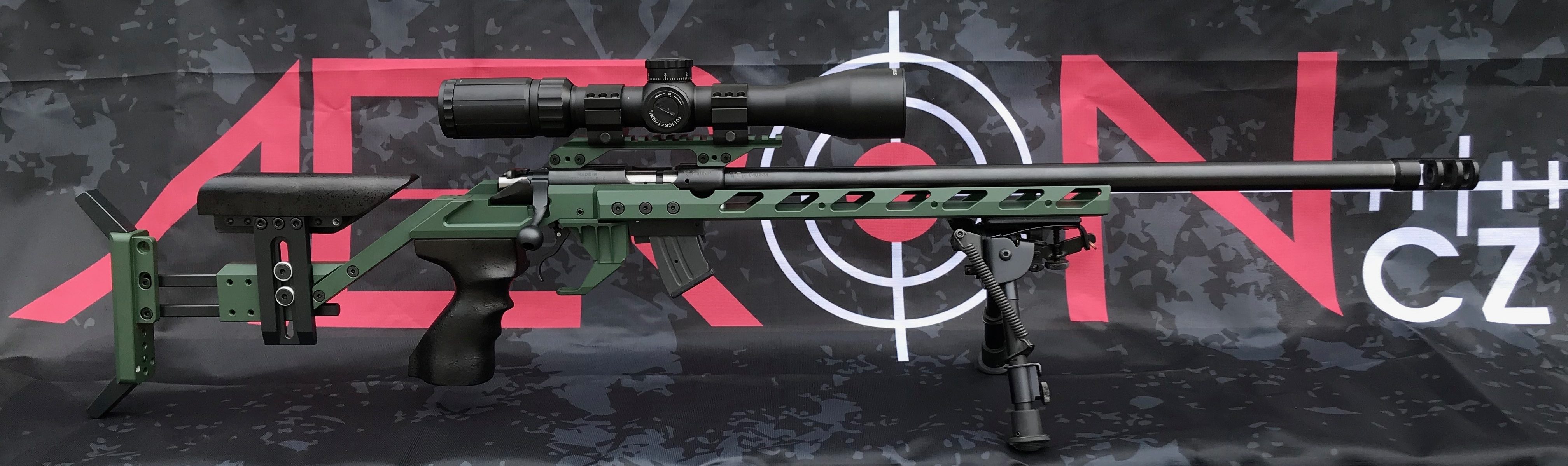

I run a CZ 452 in an Aeron Stock, but the stock will also fit other CZ models even and old Brno Model 4
That's a sweet lookin pipe Maple57. Where to purchase chassis and how many Gold Loonie coins if I may be so bold.Thanks Chris
Keep using ur dads gun and shoot some more matches. Even upgrade the stock if ur not liking it. Shoot and handle as many rifles as you can to get a feel of what fits ur style. A gun that naturally balances and comes to shoulder smoothly with no effort to aquire sight picture is quick and fluid. You will shoot THAT gun better than anything else. Its easy to buy once you are sure of what you want. Buy once with no regret, if you have to wait to aquire that gun then it makes it that much more precious. Good fortune to you in ur shooting endevours. Cheers Chris
Air Gun Source told me they were getting some, but I lost my patience and found a guy.
This is where I got it Mr Long Studley
They shipped direct BTW with no problem.
https://sureshot-airguns.co.uk/product/cz-452-455-stock-ft-pack-graphite-black-cerakote/
I added bars to the fore end to get better weight forward balance. 1/2" x 1" x 24" per side worked real well for CRPS.
As for scope height I do not subscribe to that old wives tale that lower is better. I believe the reverse is true, since it has an adjustable cheek the stock ergos can be adjusted to suit the scope. That lowers the axis of bore and creates more straight line recoil impulse. Not that 22LR has much recoil, but the point is valid just the same.

Not much gets past you Grauhanen. I’m thinking this is an advertising photo from the chassis company. I think maple57 would rather be shootin with a firearm than a camera but on this forum nothing’s a fuhr shur!I’m wantin to taste an undisclosed individuals brewing expertise. Keeps teasing us with pictures and descriptions but no sampling invites. Kindah cruel really, like puttin candy in front of kids and not lettin em eat it. On another note did some ammo testing with a sample box of SK Flatnose Match. Shot it out if my Dlask receiver/Kidd the remaining other than Dlask X5 Linear compensator. Fired 10 shot group at 50 that measured 0,462” and with me shooting quick to foul the clean barrel. Fired two five shot groups with more care in technique. First five measured 0.267” and second was 0.223” so then went to 100yds and put five on a freshly painted AR 500 target that was in the 5/8” range. Hard to get exact measures on painted target but it’s a tight group That’s more like 1/2”. Anyways only one box but I’m definitely pickin up more to try. Awesome for ORPS events if it’s repeatable. This would be great ammo for shorter range shooters and well worth a try in ur gun. Cheers Chris
That's a lot of height over bore.
That really doesn't matter. Get it comfortable, figure out your drop tables, and the height over bore is really irrelevant. Being comfortable behind a rifle is. With a chassis set up like this, or done with a normal stock and an adjustable cheek riser, its easy to get it set up well.
The standard height was 1.5" above bore. With today's scopes, that's almost impossible to do with the bell end on most of them. Shooting, and learning why happens at the different distances will yeild the same accuracy, with accurate equipment.
