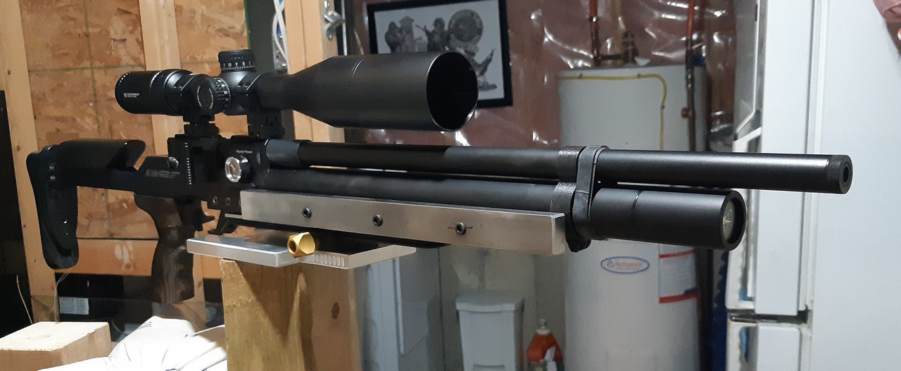

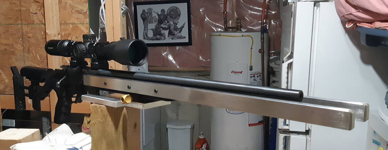

If you're interested, these are pictures of my actual rifles in Aeron chassis and fitted with MDT Arca rails.
The steel weights attached provide both weight for stability and improved weight forward balance point so the rifle can rest naturally on the obstacle as shown.
Both rifles also have adjustable scope rings that have been set to zero out 8 minutes up from the bottom of travel. This way I get close to 60 MOA of elevation and a defacto zero stop system.
CZ452
FX Dreamline
