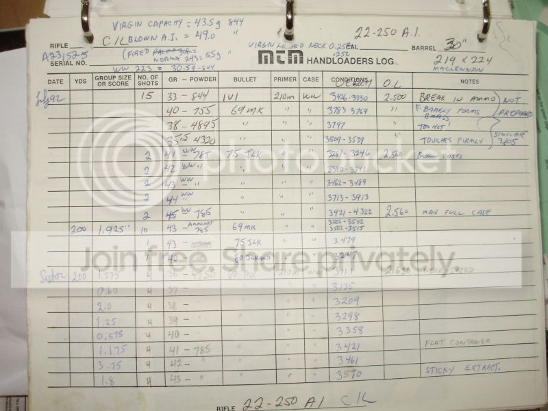

I have been reloading for over 40 years and this simple thing has always escaped me. I would print labels to put in with the ammo and all kinds of different things. Finally the light bulb came on. I printed sheets with all the specs I need to be filled in. Three to a page so there is lots of room to write. Each batch gets a batch number based on the date and a number in order, ie 20151226-006. The actual ammo gets a sticker with only the batch number and the calibre. I am not keeping the different calibres separate at this point but I may consider this in the future. I have a pile of different calibres and load many thousands per year for many different guns. If I shot all of a batch I would cross it out in my book or keep track of quantity left. I really load only so I can shoot, it is not a big hobby to me but I do it a lot with casting etc.
If anyone wants a pdf of the sheet I created let me know your email and I will get it off to you. Of course all this could be computerized by making a fillable pdf and a bunch of other different ways. I may do this, I have plenty of computers kicking around.
