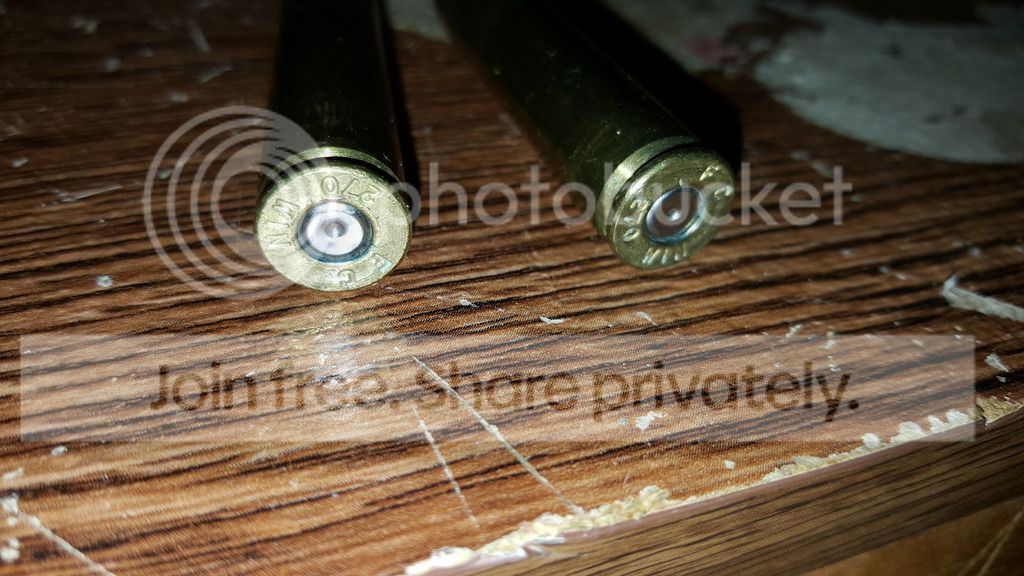

This looks like your rounds got wet
What is that geen death in around primers in this picture? Looks like oxidation from moisture. Right round looks like has crooked primer as well.
Federal brass. It's just the blue crap they have around the factory primers.

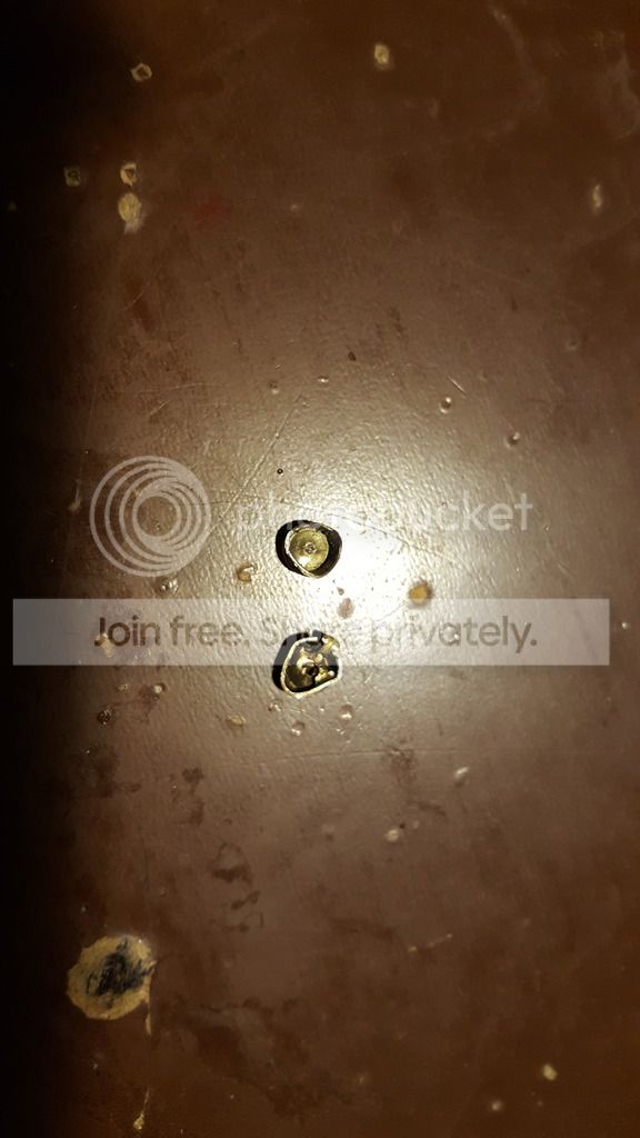

Pulled the bullets and deprimed the cases. Heres what the primers look like:

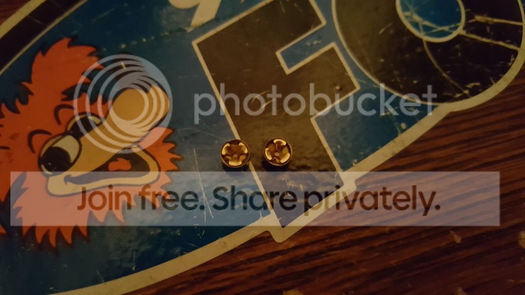

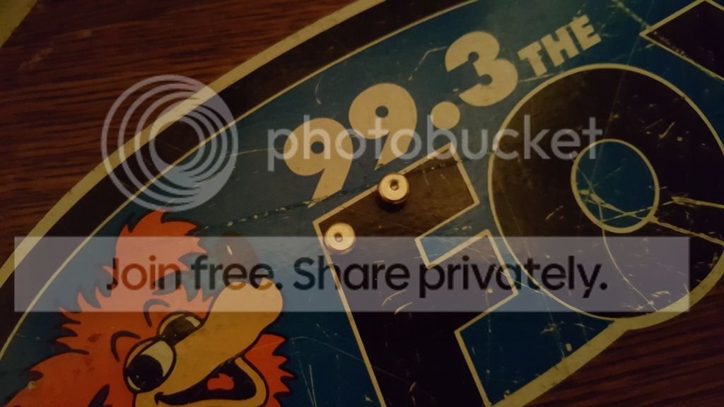

And finally, I took 'em outside and whacked 'em with a hammer...
So it looks like the primers themselves weren't the issue.

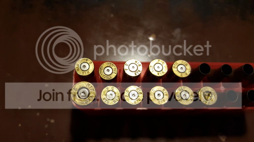

Went to the range again. 19 rounds, 1 misfire... Maybe the primers are to blame after all? The primer strike does look a little bit weak compared to the round above it, but doesn't look any different than the round to the right which went off without issue. (misfired round is the bottom left corner)

What's going on with bottom right case? Upside down primer?
Also looking at some of the other primers, some seem to be flattened? Maybe just a bad pic to go along with my phone screen. But the edges look flattened.
Yeah, a primer is upside down. It somehow flipped in the hand primer. Thats why I had 19 rounds, not 20. lol
As for the primers, they do look flatter than the unfired primer, but I think thats normal? Fired factory ammo looks the same, so I sure hope its normal...
