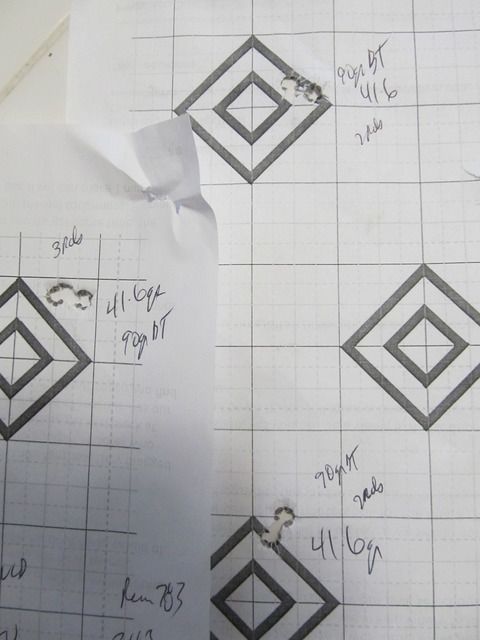

Was a blustery -6C day but really wanted to know how the new firing pin spring would work out. 3rds group on the left using new ammo and the 90gr BT.
Two groups on the right are a pair of shots each, burning up some older ammo. Results seem to be more consistent and repeatable... no weird outs.
Seems like the new firing pin spring is working out just fine. Operation continues to be very good.... bolt lift is a bit heavier then before... bolt closing needs a bit more of a push then before but still smooth.

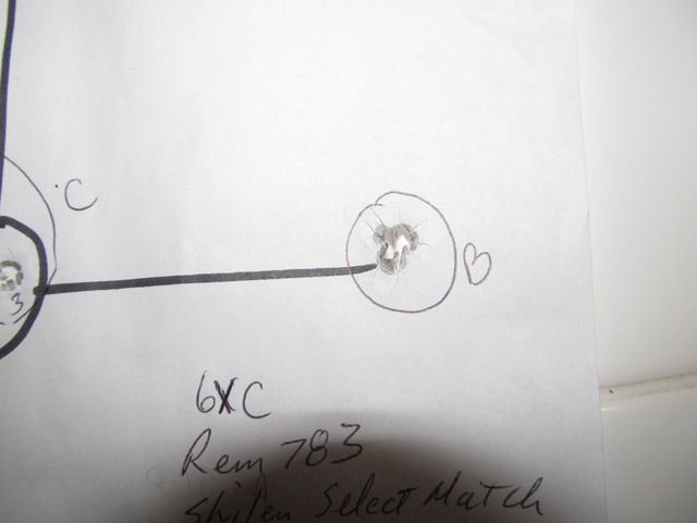

Big shout out to Terry at BARC for making the conversion from a shouldered headspaced to barrel nut barrel. Barrel is a Shilen SS Select Match #4 contour with a 8 twist, chamber is a 6XC - around 750rds fired so far.

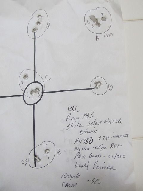

Tested the new Nosler 6mm 105gr RDF. Load work up over the range that did well with Hrn 105gr BTHP. I am using my 2nd Rem 783 which started life as a 308 Win.
Same tuning as Rem 783 #1 but today was using the factory firing pin spring. They suck and a Wolff spring will be going in asap.
Each letter is a 0.2gr increment... details are on the target of the components used. Load B is the same as I used for the Hrn 105's.
Except for load A which had 4rds, all others were 3rds. All ammo fed from the mag. I think Load B will work just fine. Load E looks like it is going back into a higher node. Give both of these more testing when things thaw and I can shoot further.
I had very good luck with the Nosler 22cal 70gr RDF in my AR and now the 6mm also looks very promising.
So if the question is "can a Rem 783 shoot with a quality match barrel installed?" Short answer... YES. Lock up is great with near 100% lug contact on this action. Fired cases extract and eject with ease. Look like they came out of my Pierce FTR receiver.. nice and straight with a well centered firing pin dent on the primer. Continue to be very impressed with this action.
