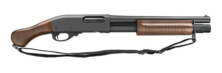

Medvedqc, I just ordered a Tac-14 Hardwood .... so I can tell you in around a week or two what my impressions are.
And then I have to ship the barrel off .... and to get the barrel threaded for chokes .....
And this winter I think I will get the receiver and barrel polished and blued .... I just love old school high gloss blueing .... :)

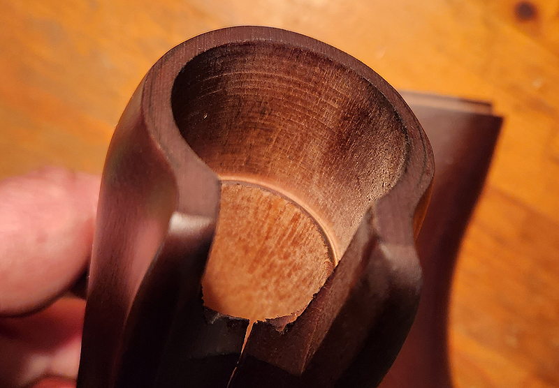

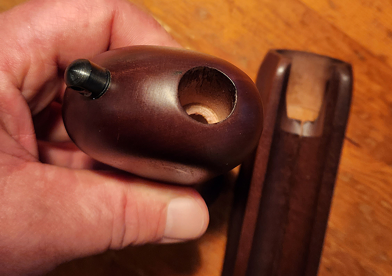

• I was really disappointed in the wood furniture … the birdshead grip and the forend are varnished on the outside …. but the surfaces that are mating with the metal are bare wood and as you can see from the pictures below. Meaning. If you use this gun a day long in the rain … the wood will swell up from the water …. And then eventually the wood will shrink again … and the finish will crack and come off in blisters. The old 870 Express guns were known for this. And nothing has changed here with this RemArms Tac-14 Hardwood.

• I applied a couple of coats of Tru-Oil on the birds-head grip inside and out and to waterproof it.
