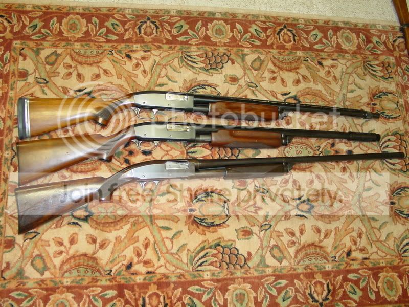

Looks like I started a pump debate. Not sue on length of barrel as of yet but would guess around 30 inch and it has a full choke. The LOP seems a little short but have to go and fire it yet. I have the original take down case for it too - at least it looks like it was made for the gun. Anyone have info on taking it apart - manual etc.
They are a dam fine gun Ted we just like to debate the old ones.
