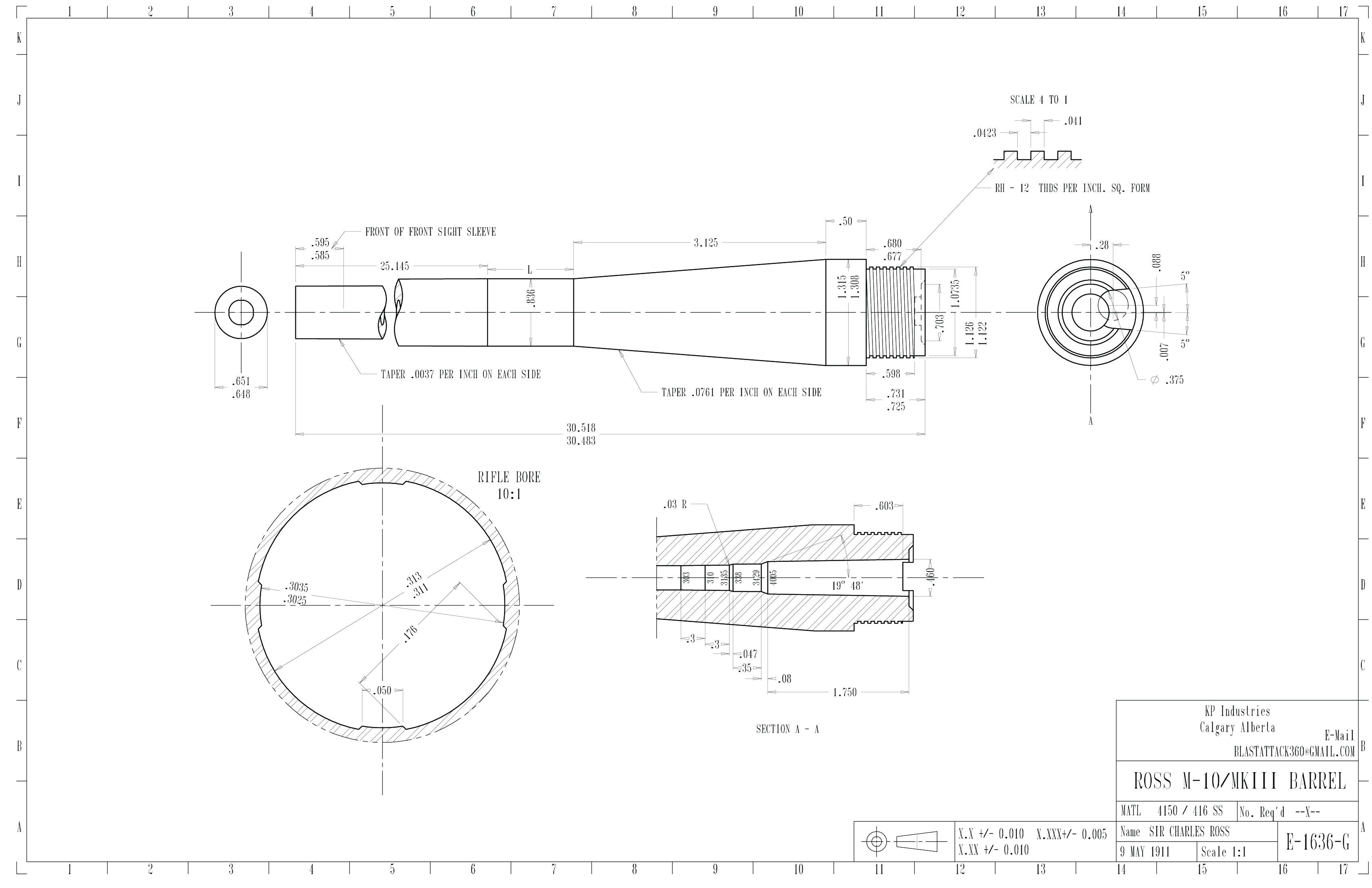

As far as fitting a new barrel to a 1910 goes, there are the square threads, plus a couple of bolt face cuts.

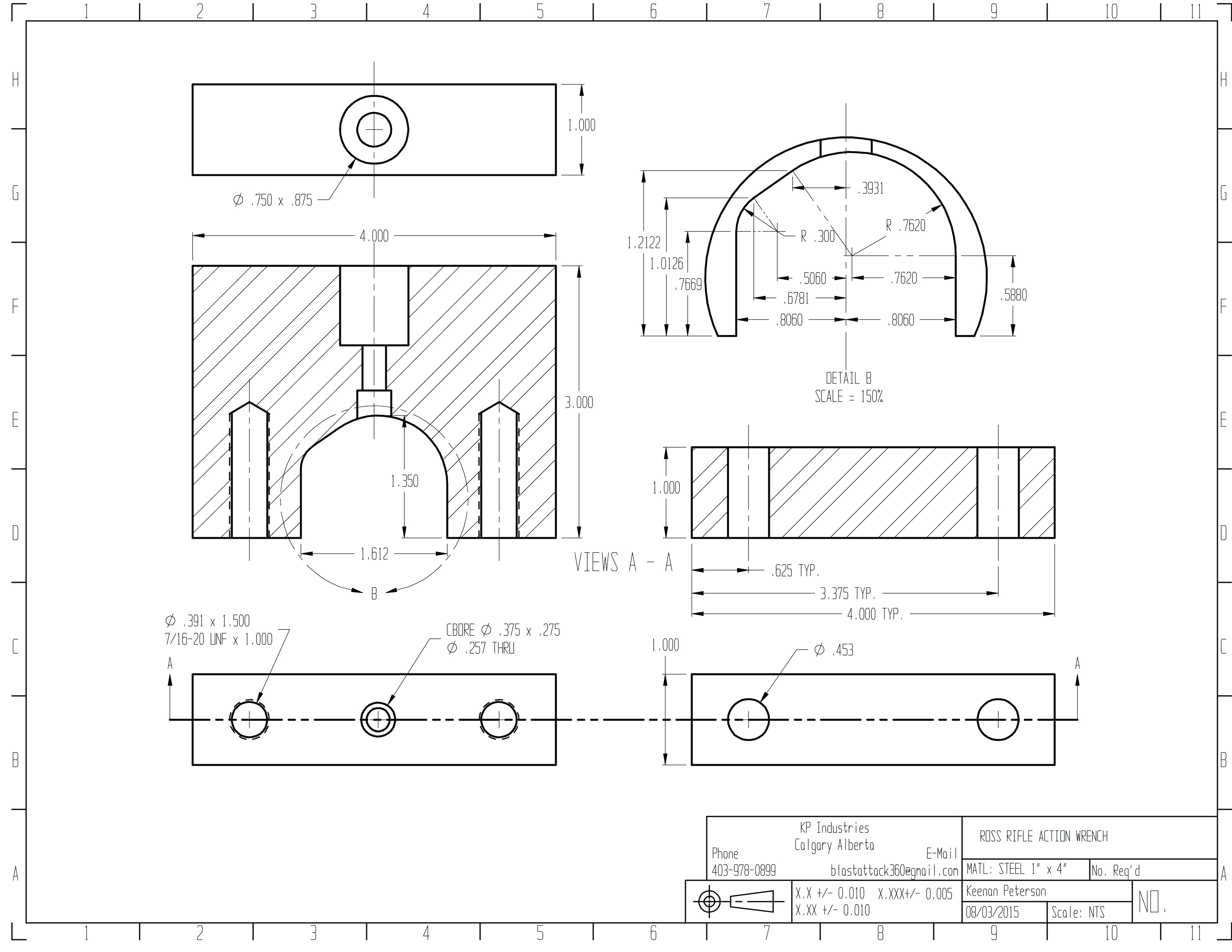

It would be very much appreciated if you could post a higher resolution version of this blueprint. It is difficult to make out some of the dimensions at the current resolution.
Please disregard this post Blastattack's drawing is apparently an exact copy and all dimensions are legible.

Yes I have a few more and a library of correspondence fro Herb Cox (who was the guru of Rosses in the mid fifties) to my father.
They were all on Rossrifle.com and were lost when it crashed.
I will see if I can figure out a way to copy the whole business again and send it to those who request.
