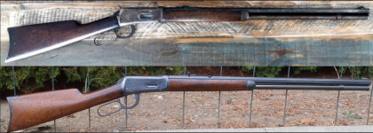

Looks awesome.Thought I 'd share a few pics of the last winny I did. Turned out okay and shoot even better!
View attachment 905677View attachment 905678

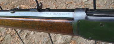

Yes, but the few I’ve seen had 30 wcf on the top of the barrel as well as the bottom.That is when that bawrill was screwed on the receiver.
It doesn’t necessarily mean the date when the rifle was nee’d.
Should be a couple three letters in that script as well.
It would identify the gunsmith in Winchesters armoury.

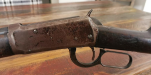

Not sure how much into it I’ll get right now, I’ve done a couple already but struggled with the rust.If you like restoring, I'd invest in a good ultrasonic cleaner. Mines been invaluable.
rust covering - you probably already know - is possible to turn red rust into black rust "bluing" by boiling it, carding it, boiling, etc. until dark enough for you - final soak in oil - seems to work out fine if the thing is not pitted too badly. Else, will probably have to fill pits with Bondo or Epoxy - sand smooth and paint it. Or live with pits.Looks awesome.
I got some rust covered in a good helping of varnish piled on top.
No pitting and not a lot of rust. The back of the buttock plate, back of the rear sight and the inside of the magazine tube are the only rusted areas.rust covering - you probably already know - is possible to turn red rust into black rust "bluing" by boiling it, carding it, boiling, etc. until dark enough for you - final soak in oil - seems to work out fine if the thing is not pitted too badly. Else, will probably have to fill pits with Bondo or Epoxy - sand smooth and paint it. Or live with pits.
Compared to how it started I was pretty sure I couldn’t make it any worse lol!Looks like that turned out just fine. Thanks for the pictures
Cold blue may work if the extremely thin iron plating is still intact.Sure they can, I’ve cold blued a 70’s m94. It came out great.
HeySerial # put it as a 1975 year of manufacture, first two coats of cold blue went on splotchy looking. The other 4 were smooth and darker with each application, it was taken down to the white with multiple grits of wet dry paper wrapped around a flat file. Degreased very thoroughly.
Here’s the before picture lol
