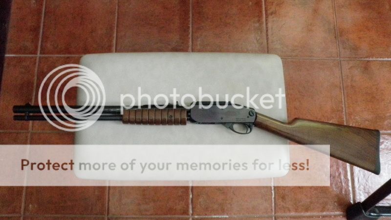

I have barrel liners and the correct drill bit is on the way. I am deciding between aluminum and carbon fiber for the sleeve. I just need to get the sleeve machined somewhere because I on have a 7 inch bed on my lathe.
I am going to make a replacement 13" barrel for my Stevens 300F (same as original) and mount the whole thing in a collapsible aluminum skeleton stock that locks the bolt and
Trigger when collapsed. With the mp5 style stock collapsed the gun should be about 19". Not sure what the weight will be yet, but I doubt it will be less than 24 ounces.
I haven't figured out what to use for a pistol grip yet. I with either make a minimalist one from black delrin or I will attach a MOE at grip for the storage space if it's not too bulky. I am excited to see how this turns out

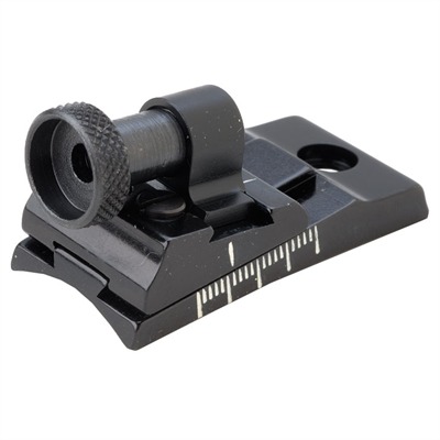

I will try my hand at making a receiver mounted peep sight when it's all done. That should give a sight radius of about 16.5"
