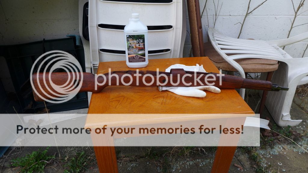

After one coat of BLO:
Disregard the crap at the back of my garage :redface: , have to go to the dump soon.
So far I'm very impressed after a very thin coat of BLO. I sweated out a lot of oil from the wood, it seems to be drinking up the BLO like nobody's business.
I have 3 coats of BLO now, think I'll just touch it up now and reassemble. Will take pics of the final result when I get it together.
Finished! About 5 or 6 light oiling sessions and letting it dry, with BLO... Very happy with the result. Looks true to the history of the rifle and I'm ecstatic. Sanded very little (leaving the flaws), if at all in places, just with fine steel wool. Only thing left to do is fit the buttplate, need to sand off a little so it will fit properly. Maybe give the buttplate a buff and get the black marks off of it.
