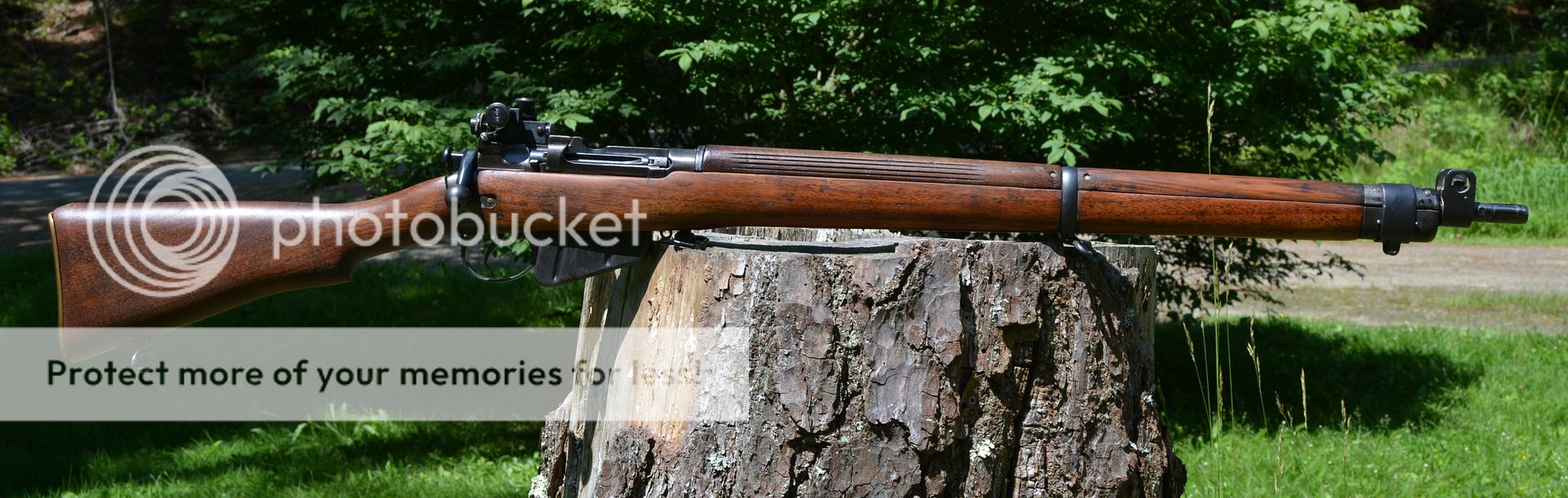

Seriously, nice work Rumpelhardt. Here's some pics of my last project. I just finished it this week. I had a frustrating time hunting up Long Branch parts, but I was lucky for the most part. You can see what it looked like when I got it, and what it looks like now. It's almost identical to your build.
I like the dark wood on yours. You did a great job.
I don't have all Long Branch parts on mine but I did find quite a few and I'm replacing the others as I find them.
I like the PH5c sight a lot I'm looking for an Iris type eye piece now.
