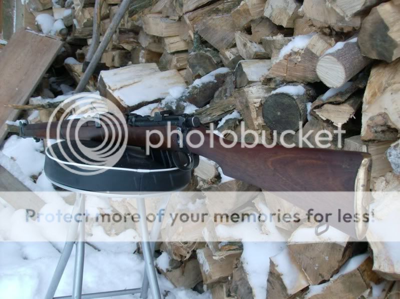

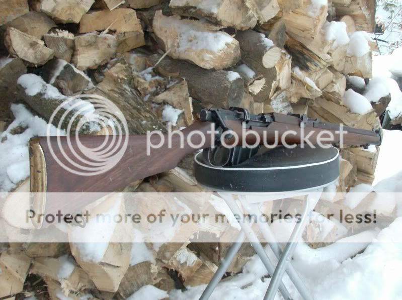

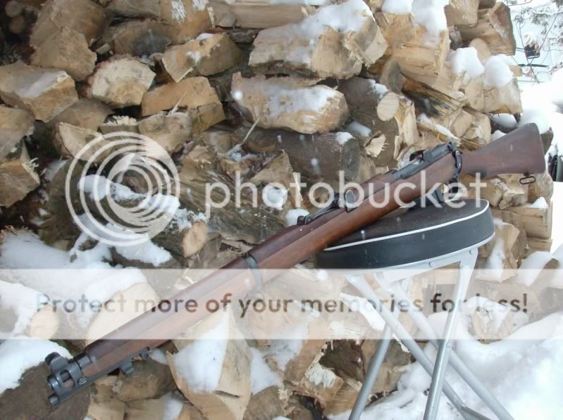

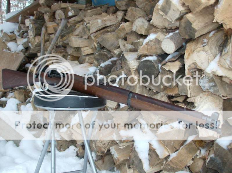

After 20 years, I finally have a Lee Enfield again... I got this British No.4 Mk2 from our very own louthepou & he reclaimed it from Bubba... Here is what louthepou said he did to this bubba'd rifle after he got it... All I can say is, it sure is pretty!
"This gun came to me as a sporter with such a good bore that I took the time to find wood worthy of it. Took a bit of time, but found a new set, pale wood, made for the Mk2; lucky find, I have to say (most new stuff you find for the No4Mk2 are indian walnut).
I bedded the forend, free-floated from knox to just before the muzzle, with the upward pressure at that end. I had to put tiny shims at the front to make sure there's no interference between the barrel and the front handguard (I'll show you if you drop by). The bolt matches the receiver, and the magazine has a different serial number but in the same range (serial starting with "PF", weird coincidence?). The rear sight is from Fazakerley, like the gun. So an above-average shooter, with very nice fit and finish. I put a bright and shiny brass buttplate to finish things off."
