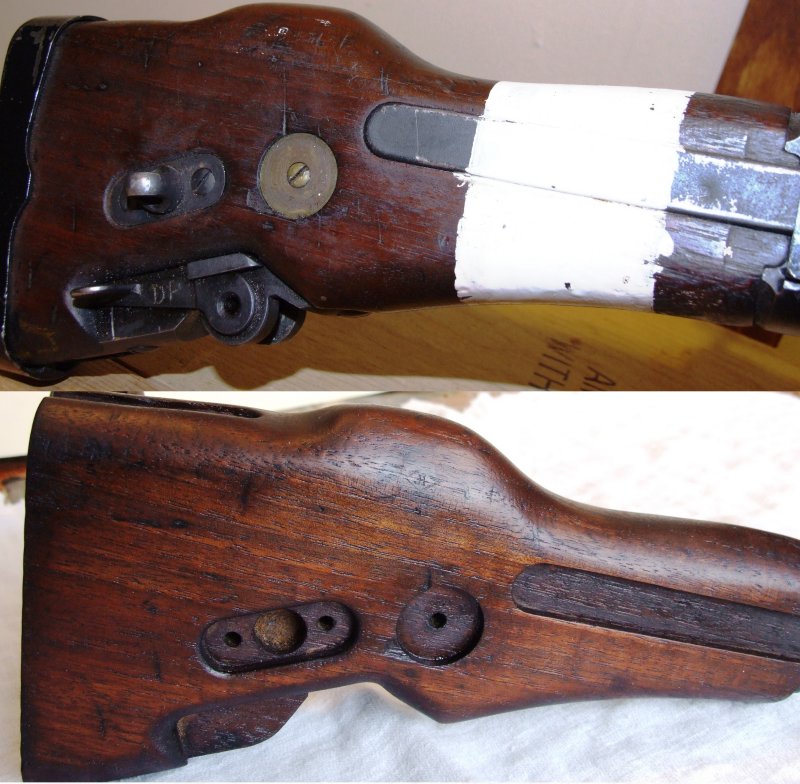

My meager contribution is a Mosin M-44 that I bought as a barreled action. I have a few complete bolts that I've added. With the purchase of a complete stock set and sling from a fellow CGN'r, I've simply assembled a full military M-44. Not fancy but it's back to original pretty well.

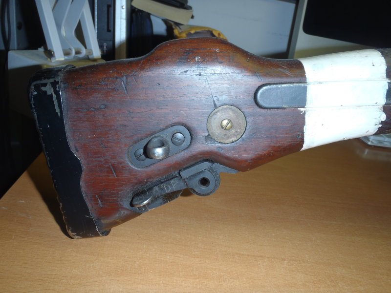

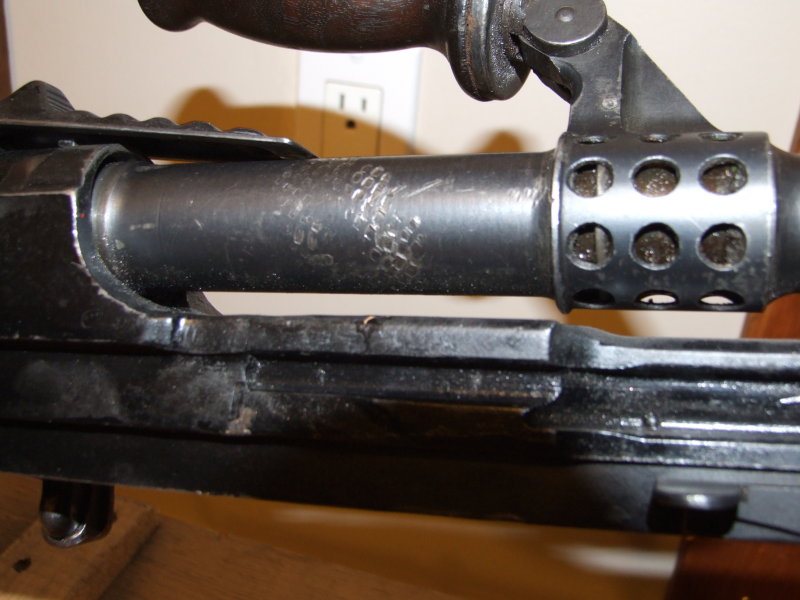

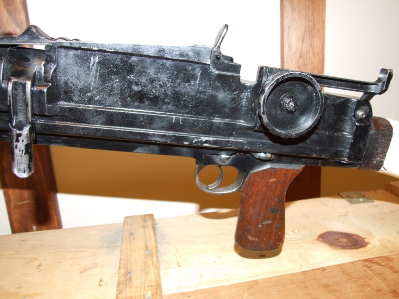

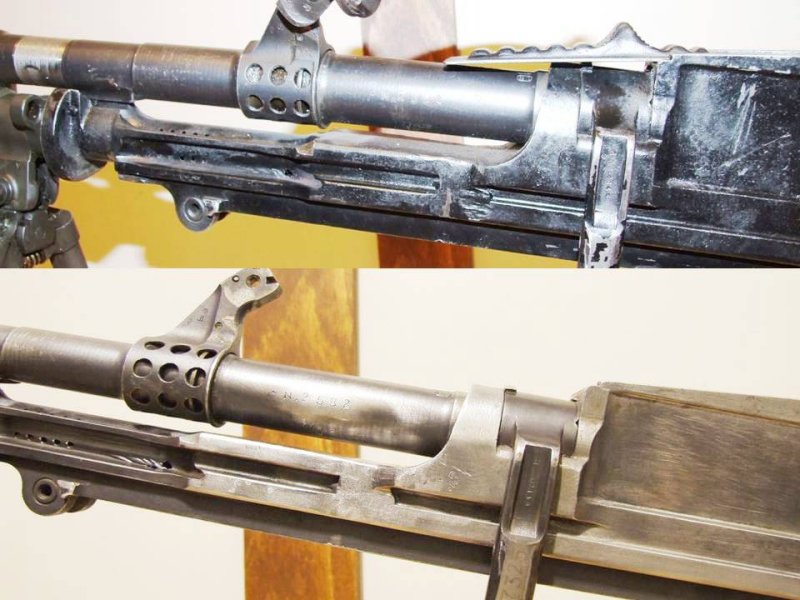

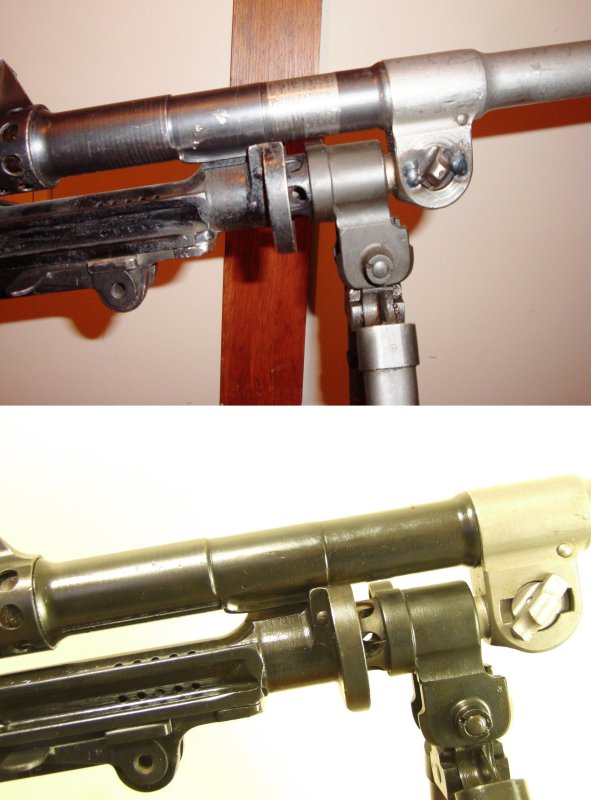

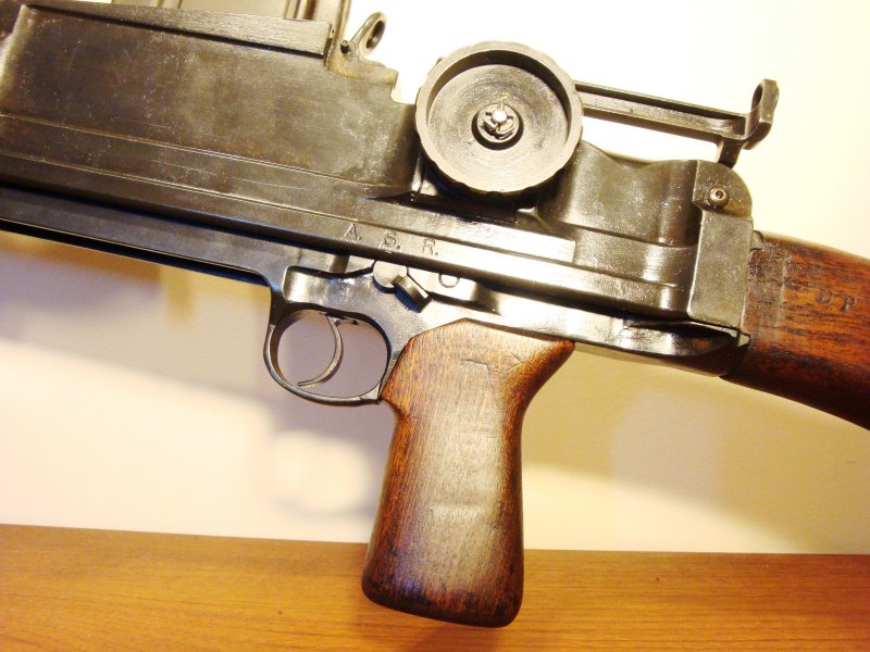

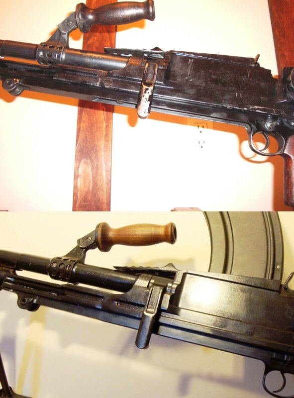

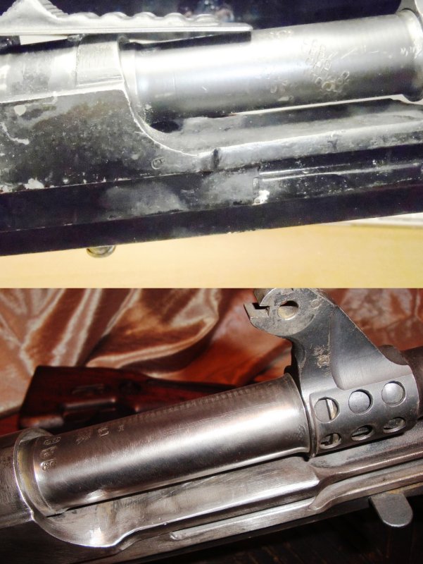

Bren MKIm deact I am working on for somebody. It was probably one of the worse welding/deact jobs on a gun like that I have ever seen, and on top of it all they used black spray paint to seal the job.
Anyhow its a work in progress. She'll never ever shoot again but might as well make her look good again. I cleaned up the welds as best as I could for now, stripped off the paint, wire brushed the receiver and barrel then filed off as much slag as possible and made things at least look more symetrical.
I have cleaned off the stock, removed the white paint and applied a stain/BLO mixture over a few weeks. Mostly BLO with a spoonful of stain to hide the dings so I dont have to sand much if at all.
Anyhow as I said its a work in progress

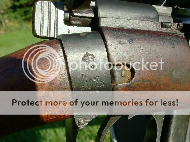

i refinished my #4 mark 1 but didnt retrofit it. i reblued all the metal and as for the stocks i sanded it all down and used tong oil. 2 different tones where the rear stock is walnut and the front is beech but i like it and is unique. i did have a small tasco scope on it when i bought it and before i started the refinishing i bought a 3-9 by 50mm tasco but who ever drilled and tapped the holes messed up so i filled them in and now i am putting a t.z.4\47 parker hale sniper sight.

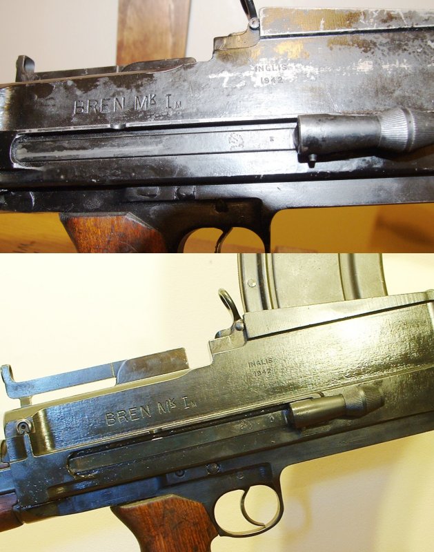

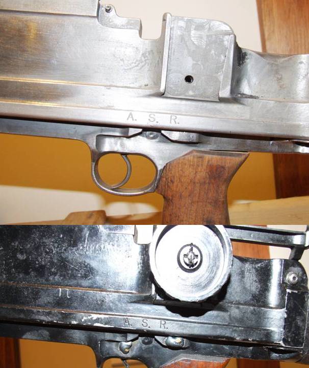

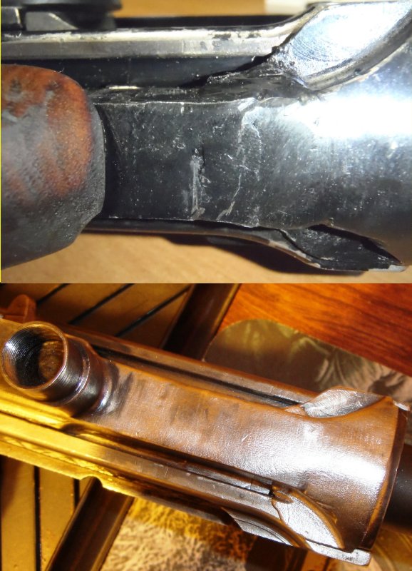

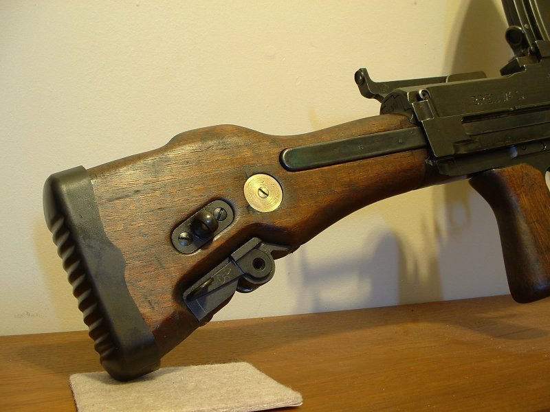

I forgot to update: The bren is complete by the way I finished it in the spring. I cant for the live of me remember if I updated here.
Anyhow it was some of my best work: This thing was just disgusting when I got it, it was spray painted with what looked like dirt underneath it.
The welds must have been done by Stephen Hawking.
Anyhow enjoy the pics.

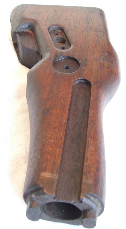

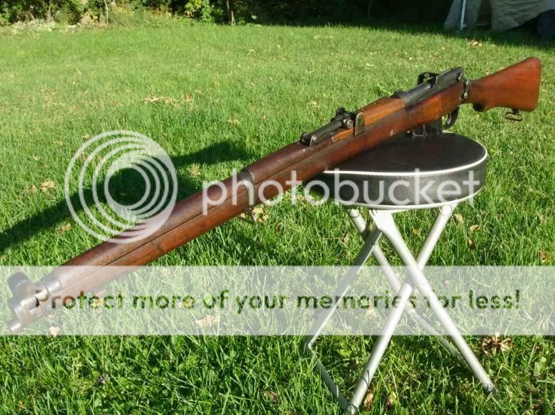

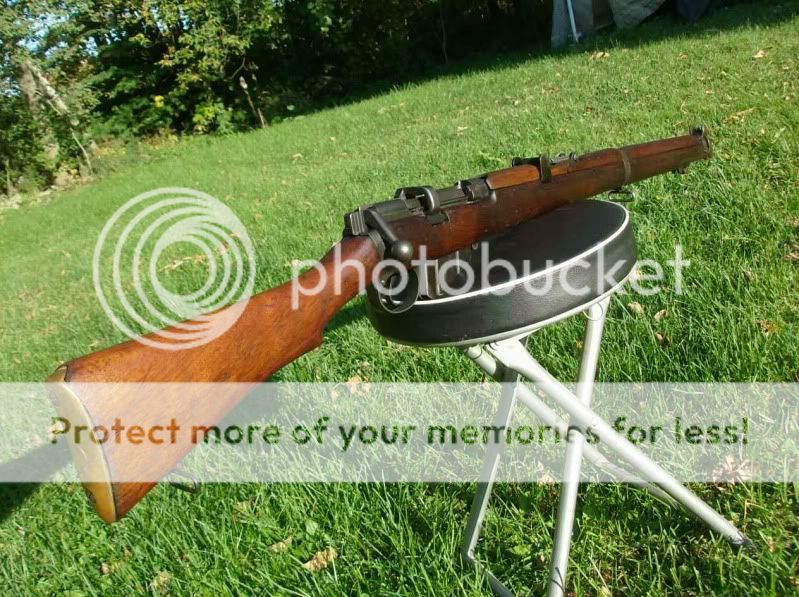

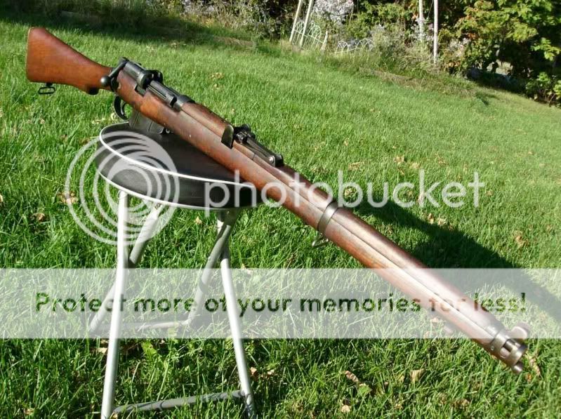

Lee Enfield Carbine refurbed for CGN member "Gary":
Wonderful job Lou. It would be all to easy to overlook the fact that LEC parts are made of 100% unobtanium, and thus you've actually handcrafted them (metal bits aside as they were the unobtanium that made this seem remotely possible). The Forearm from a very nice and increasingly rare MkIII forearm which holds a few more similarities to the LEC than a MkIII*, but still required tremendous work reshape into a true copy of the LEC. Seeing the results, it was indeed a worthwhile sacrifice. And then the upper hand guard, to which there is no reasonable match and had to be recreated from scratch. I am honoured to be the recipient of your best work yet. Huzzzah!

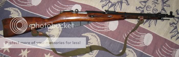

Mosin Nagant 1944 Ex-Sniper Restored. Scope is also 1944 made. Very happy with how the project turned out.

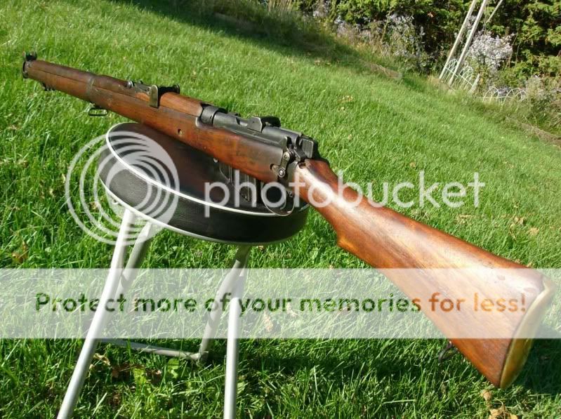

Just finished de-sporterizing this one:
Here's my first ever milsurp: my Dad gave me his sporterized 1943 Longbranch #4 Mk1* that I restored back to "circa original". (He liked it better when it was Bubba'd :() It's thebottom rifle, obviously...hey Lou, does that P14 look familiar??:p
Indeed I think I've seen that Enfield before! :D Very nice trio you have there, by the way. ;)
Just a question, do you know were to find a stock like this one? I would be interested in getting one.
I find sporterized Lee Enfields in classifieds here and there, or by browsing websites of gun shops which sell used guns. Often the guns need work, sometimes there's nice wood hidden under flaking varnish!

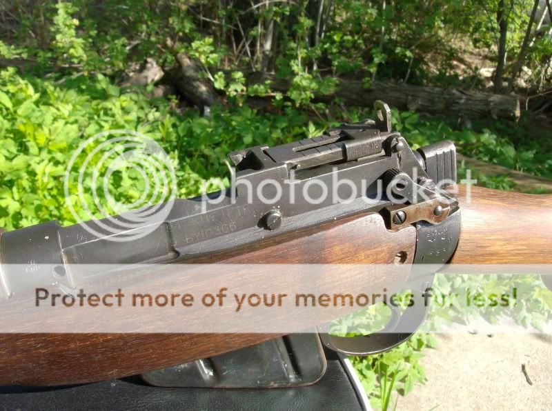

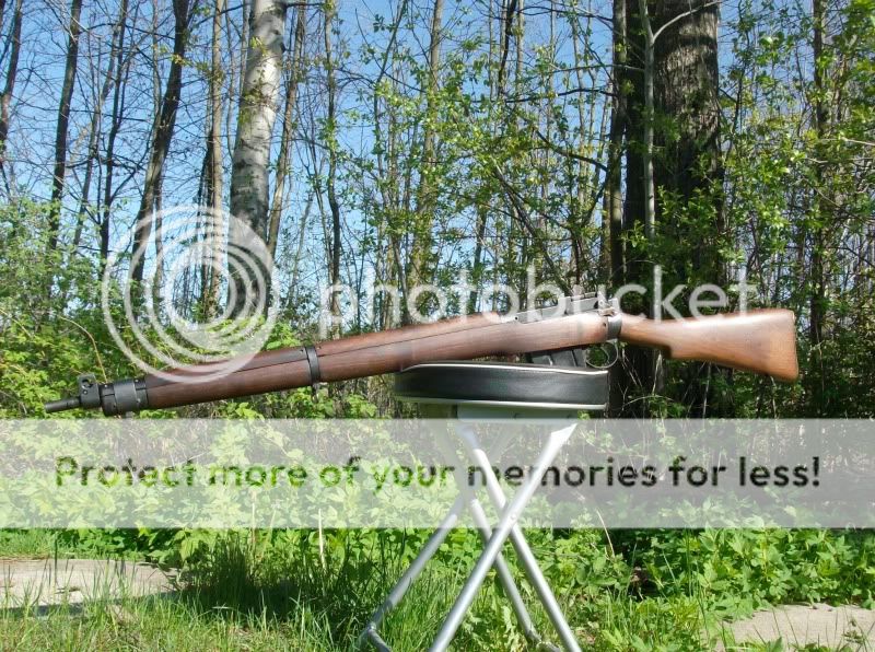

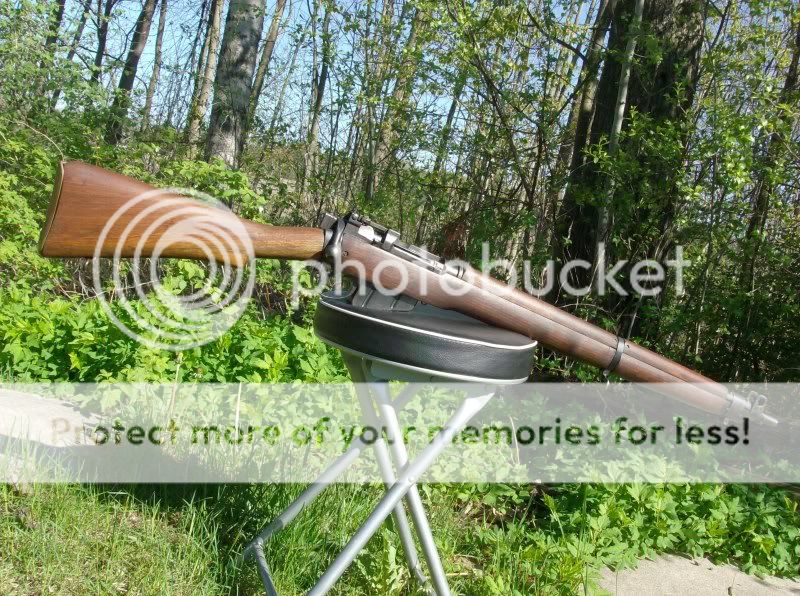

Here's a No4 I recently finished refurbing a couple of weeks ago. Got a sporter with a good bore from CGN's Jimbow47 and had the required furniture and hardware. I converted a Mk2 forend so it would fit on that Mk1 rifle. I've got another butt stock which matches better in terms of colour, I may put it on before selling the rifle.
Keep up the good work, guys!
