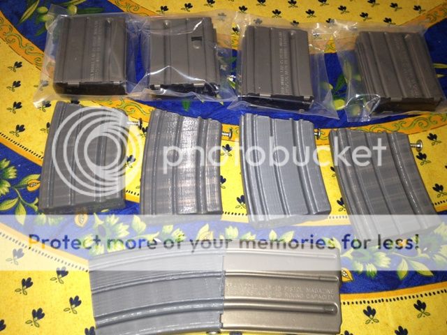

Here are the magazines, brand new and out of the box from Ryan at SFRC another CGN dealer... I played and installed the first one, it's at the bottom of the picture:
As you can see, the 10 rounders are still in the plastic factory wrap. See how the 10 rd magazine extenders appear? That's how I got them from GS Design here in Guelph, ON. They are made with some tough plastic and contoured to appear like a normal 30 rd AR magazine, lines, stampings and all flow smoothly. :D

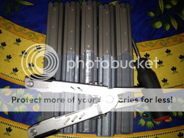

Okay, in this picture, I've got all the 5 magazines assembled and you can see that the mating surfaces are pretty darn good with very few gaps. They have done their homework. Have a look:

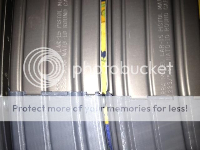

Even closer look. No gaps. I'm really impressed. Everything came together very well. No nasty surprises....
Here's a side view of the contact points when the magazine extender is fully installed. I'm loving this schtuff! I'm gonna rock this set of magazines at my next CQB match in 02 Nov at Base Borden. :cool:
