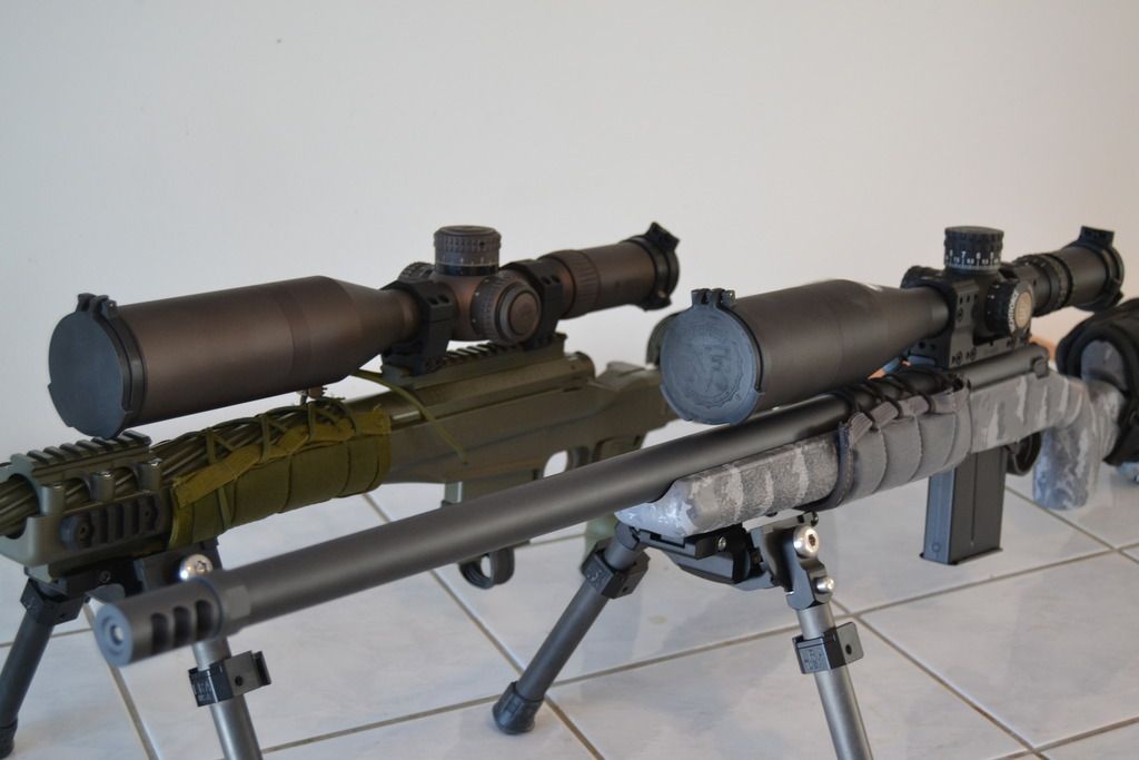

RE: The Vortex was secured using Vortex (Seekins) 34mm rings while the other scopes sat in SPHUR one-piece mounts.
From Bob's blog he is using Vortex rings.
What rings are folks using? Pros/Cons.
For my SRS-A1 looking for 20 or 30MOA rings with built in level. The SPHUR???
DT?
Bob, I think its time to clean the lenses on your PMII :p
LOL ! Yeah - no kidding. Seriously, who would have thought that me of all people ( a S+B snob ) would be choosing Razor II vs ATACR for top rifle and moving the PMii down to one of the lesser-used. What I really want is ATACR glass, Razor turrets and reticle, Tasco price and S+B brand name recognition :)
For 34mm tubes I like the Seekins rings ( branded Vortex ) which are good value, NF rings and TPS rings as well as, of course, the excellent (but expensive) Spuhr.

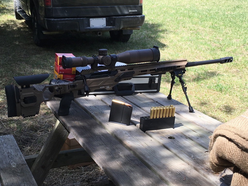

Yeah, the CADEX mount is really nice, I have the bubble-level top as well:
Time to do some research on unimounts.
Like the ring cap level. Didn't like the cheap aftermarket ones, these factory ones look practical. I prefer my scope mounted level more than pica mounted.
