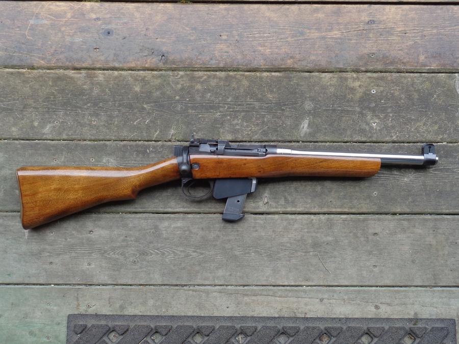

I did my one up using a Special Interest Arms kit from North Shore Barrels before they closed up shop.

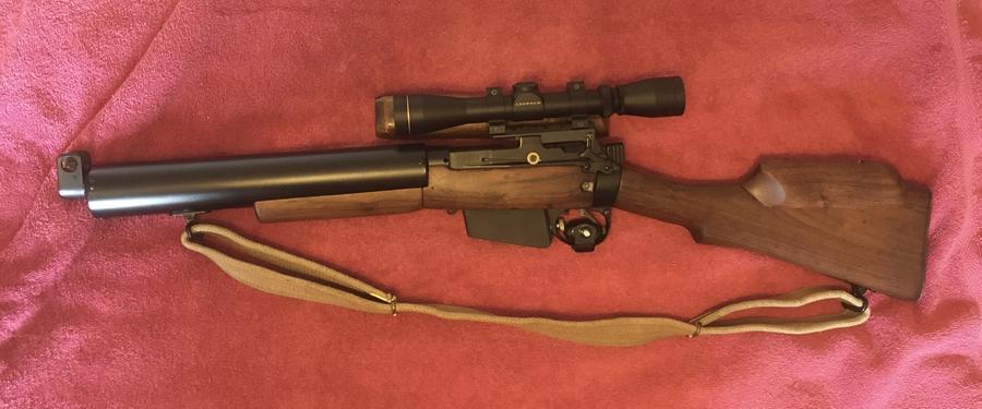

put this one together back in 2012 from the NSB kit from SIA ,same parts kit as Shell Shucker..Fake can from 2"thin wall tubing and end caps are frost plugs.This is a #4 with the no drill scope mount and the #4 front sight and can put in the rear peep also
