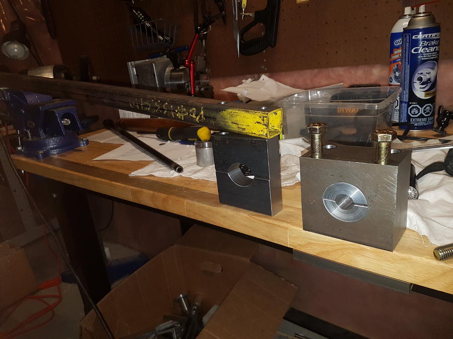

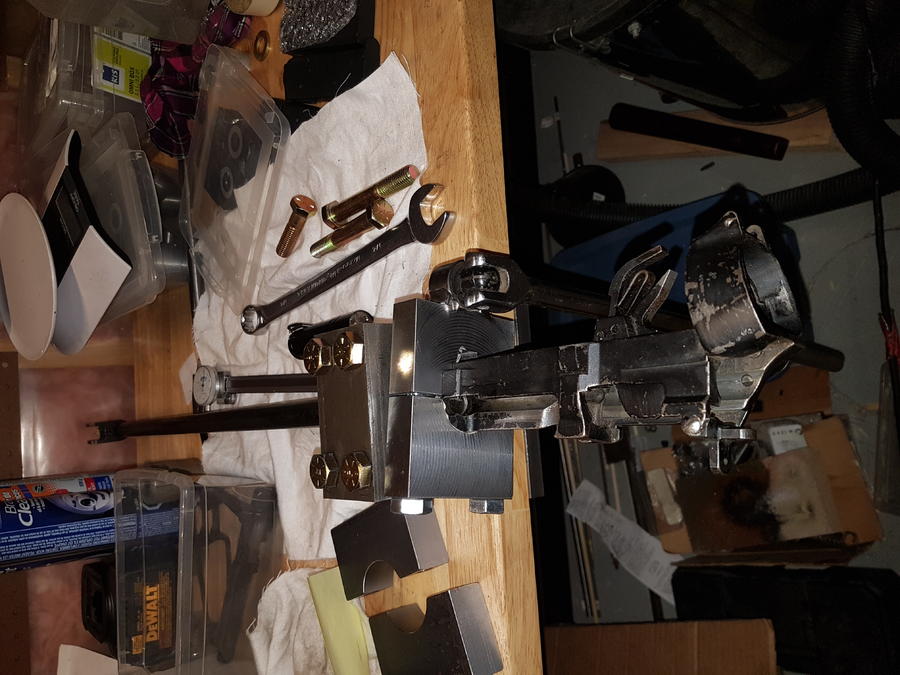

I have removed two enfield barrels using my lathe. Now I use a barrel vise and action wrench that I made and it works great. Even managed to get a barrel off that had a hidden screw that went through the receiver and into the chamber. It stripped the threads but I can chase the receiver threads and use it for something.

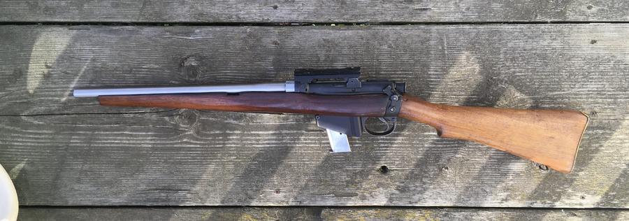

measured mine and its 16 1/2 inches and profiled like the one in the video.

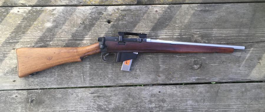

put the kit together and it don't look so very bad .Used a #1 LE and just mocked it up
not too impressed with the mag release but that can be tinkered with
A51523A5-AEF8-4144-94C6-977D955B2A7D_1_201_a.jpgFEC090A2-5A17-4206-ABF4-8F5015000706_1_201_a.jpg
