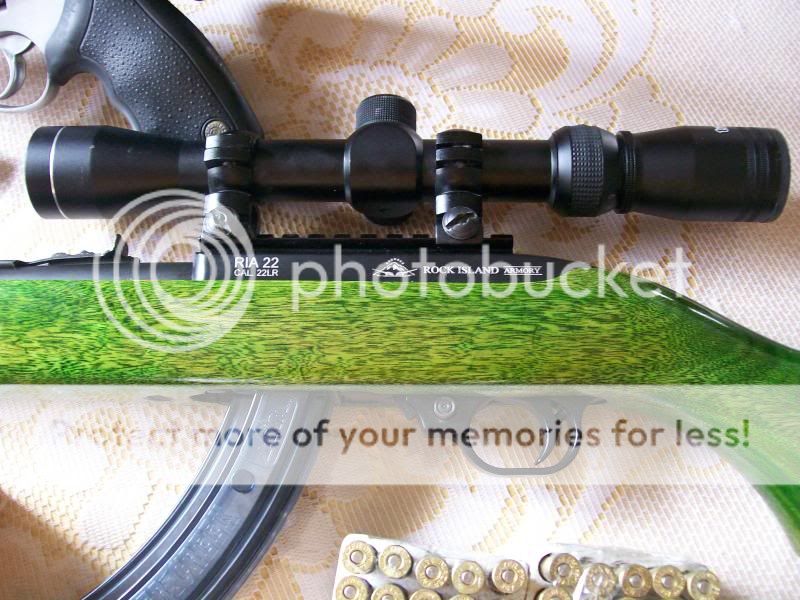

Great review-thanks! I just one of these up for $129 new in box and the thing was so dirty it looked like someone put about 1000 rounds through it.? Stripped it down and cleaned it up, mounted in stock(had to drill to enlarge the forearm bolt hole like you said). Will report back after I shoot it.
OMG weren't they dirty?!?!??!!
i was disgusted by how dirty they where, ive had guns that ive shot all summer that were not as dirty as those guns came.
i was mystified by how the bolt faces where caked up and these guns are listed as new....... i dont know, seemed a little strange.

Ya there was a stack of them in the store and the first one I looked at I thought it was a joke because the thing was so dirty, I took one from the bottom of stack but same thing. At first I thought these are used and abused? Except the parts are not worn or scratched-just covered in dirty black oil/grease. It's not packing oil, it's a dirty gritty oil? We will see how it shoots next.
I like the M22 great gun if you are going to buy it and be happy with the stock gun or even add an after stock barrel. Its a quality 22 that is affordable. I did a little video on one if you care to watch. If you want a fun gun that you show your kids how to shoot or knock cans around I would get one (maybe 2) depending on how many kids you have :)
