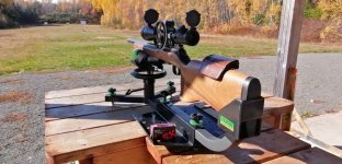

Wellll, Here's my VMTR that cost $1100 Used, with the Athlon Argos G2 8-34x56 that cost $700 tx + shpg New. The cheek-pad is foam + Gorilla tape held with Alien-tape :rolleyes: The rest is a 10+ year old Primos "Group Therapy" that's obsolete (cost $90 + tax). And SK-RM ammo - random Lot #.
I shot a 0.584" group @-100yds just b4 a 100-yd challenge of 1.456" Avg. w-none under 1.136" last Fall - no 'good days' this year.
