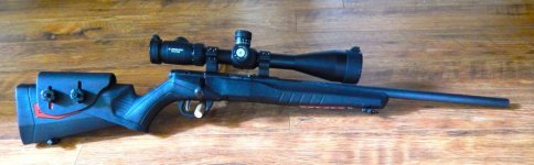

And, brendon, I put one of the Athlon 8-34x56 FFP scopes on my Savage B-22 with amazon-generic 'medium' rings with plenty of clearance . . .
