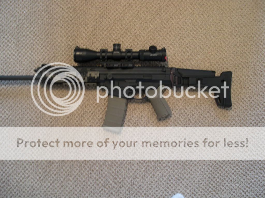

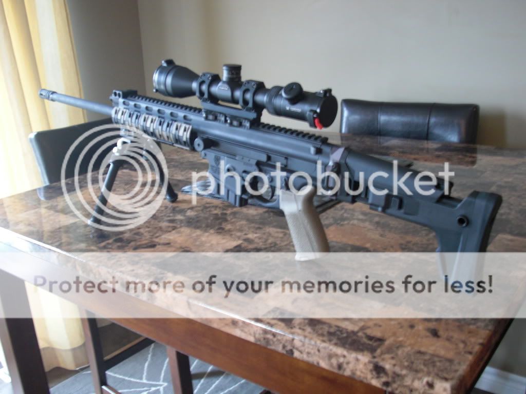

Got my ACR stock adaptor and ACR folding stock on the XCR
Much Much better check weld and the adj LOP and comb are nice.
Here's another pic
The pics make the adaptor look purple but it looks black in person.
