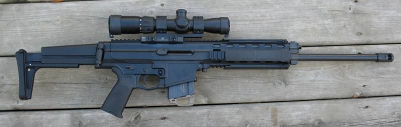

I bolted on my new FAST stock yesterday in place of the fixed version. Seems good so far.
what kind of sling mounting options on that stevo?
That looks dead ###y...
Thanks.
The stock has a single QD swivel hole on the bottom of the stock adaptor and I suppose you could use the hole near the butt plate for a 550 cord or snap hook attachment point. There's no other built-in sling mounts on the rifle, so I also have a sling slot attachment on the left side rail.
Thanks,
I've been using a snap hook on the second gen but have just moved my sling to wrap around the bottom part.
I've been agonizing over the FAST because RA is pretty vague on where/how to attach a sling.
