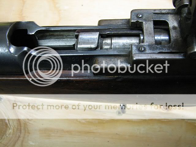

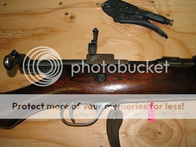

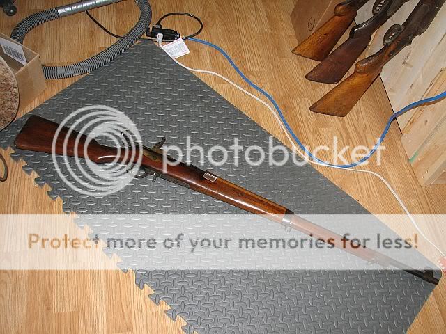

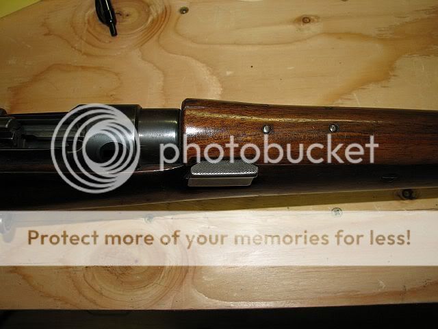

I have a full wood Ross rifle with a different rear sight than what the 1905's pictured generally have. It doesn't seem to have a serial number either. Can anyone help me out with any info on this old beast. Thanks in advance for any help.
kjohn
Does the muzzle poke out about 4 inches farther than you would think necessary? Ifd it does, it looks odd.
There were quite a few Mark II Match rifles (which is what I am pretty sure yours could be) sold to various rifle clubs throughout the country, but really a lot in Western Canada. If you go to a community museum, they will usually have a photo of the local rifle club on display, taken 'way back before the Great War. The rifles almost always are Mark II Match rifles with the 30-inch heavy barrel on woodwork that was designed for a shorter barrel.

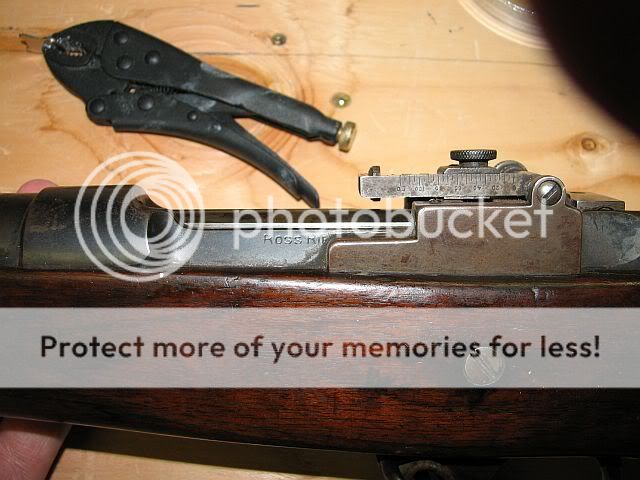

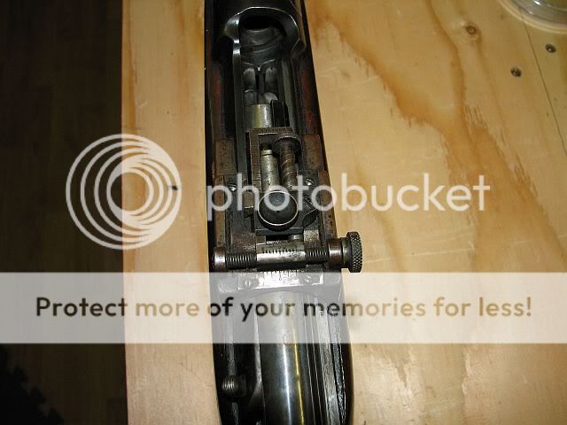

This rifle has been used for match shooting, that's for sure. Neither the foresight hood nor the entire rear-sight assembly are even close to "issue", nor is the rear sight the one which commonly came with the Mark II Match rifle. This one has a MUCH more solid mount; the commercial Mark II Match came with an aperture rear sight, but it was mounted on a stamped sheet-metal cover over top of the rear end of the action.

A very interesting and unusual toy, that much is certain. With sights like those, it should be just wonderfully accurate if your bore still is okay.
Congratulations!

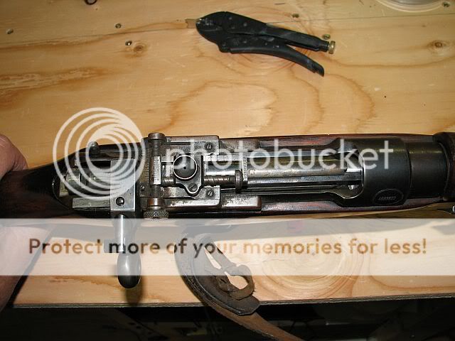

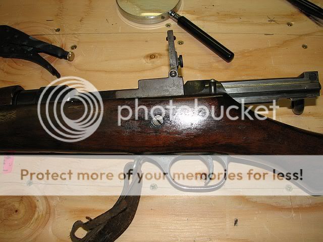

The rear sight and bridge are new on me for sure. I've never seen anything like that bridge...how is it attached? There are usually screws threaded into the receiver, can't see any?
I wonder if the bridge is home made and silver soldered on?

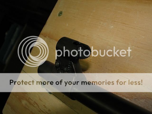

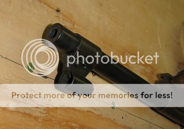

The front sight cover looks like one of the ones that pivots up. I've seen pics of them in The Ross Rifle Story, but never anything that clear.

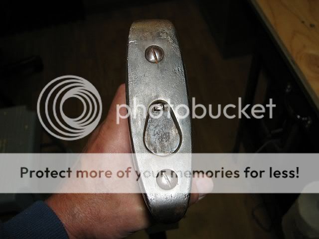

BTW, is there any info stamped into the right side of the buttstock? No small s/n stamped into the left side of the barrel just in front of the receiver?

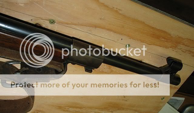

Could we see a few more pics please showing the whole rifle, including the barrel just in front of the receiver?

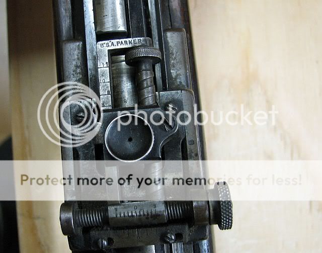

What name and info is found on the rear sight?
Very interesting. The sights definitely say quality. As far as I know none of the rosses had serial numbers on their metal, so no surprises there.
What's it chambered in?

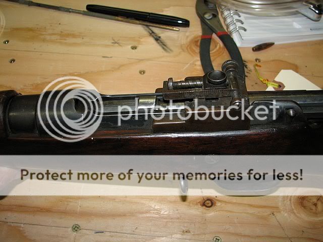

Here are a few more pics. Can anyone put an approx. $ value on this rifle?
There are no markings on the butt anywhere, no small numbers on the bbl. I would think that the sight bridge is likely fastened under the stock, out of sight.
It is a Mk. II** target rifle.
The bridge andrear sight are unlike anything I have seen previously. Front sight with pivoting hood is typical. But when you are dealing with Rosses, and target rifles, expect that there will be variations. Usually bridges are attached with screws. They are likely below the stock line.
Most commercially sold rifles do have a serial number stamped on the left of the barrel breech, just above the stock line, between the receiver and the handguard. Most military issued II** rifles should have the typical markings on the right side of the butt. I suspect that your rifle is civilian.
The absence of provisions for a rear sight on the barrel suggest that it was made later in the II** series.
If the bore is sharp, the rifle will be a fine shooter.
Nothing really unusual, other than the receiver bridge. The rifle itself is clearly a MkII**, almost surely a Commercial.With the 30 1/2" barrel fitted to "short" wood precluding fitting a bayonet, only Commercial. All four variations of the Military MkII** fitted a bayonet. Only the first variant had "short" wood, but by using a long "sword bar" on the nosecap, a bayo clipped on. If there's no Factory-applied serial on the barrel just ahead of the receiver, I'd suspect a skilled gunsmith who was capable of milling/fitting/attaching a one-off base likely ordered a replacement barrel from Ross and then fitted it himself. Had Ross fitted it, the original Ross-applied serial would have been stamped on the new barrel, then a same-size "2" would have been stamped right below the serial. The rear sight is a CanTool Commercial; nothing unusual at all. It will be clear to anyone who has read sales literature from Ross that his Target rifles were normally sold without a rear sight, on the understanding that anyone interested enough to buy a dedicated target rifle would also have definite opinions as to just which sight he preferred. The "barrel replacement" offer is also in print.
The foresight hood was an option from Ross.The hood tips forward. With the one-piece topwood, the rifle would have been from the last 30% of production....original serial likely between 6,500 out to the end.
If you have either the patience or desire, you could either search this site under "Ross####" courtesy CanTom, or visit RossRifle.com and check out the Photo Album section and check out perhaps twenty sight variations on MkII**'s from my collection. My four variations of the Military MkII** are also shown.

I am curious about whether the wood is actually inletted for that rear bridge.

This sight was designed by AJ Parker in 1910 (Patent 1721/1910) and first used at Bisley.
It would appear that the Canadian government bought the right to manufacture the site in Canada (1912 ??) and was intended to be a replacement for the Sutherland Sight used on the Mk 2 ** rifle.

Hi Kjohn
From your photos, clearly the BSA Parker site referenced in Edna Parker's book.
