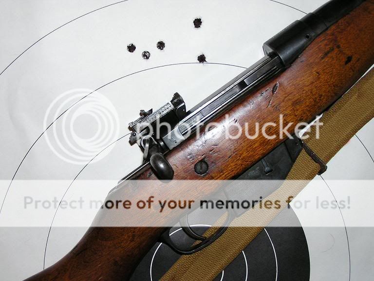

Took it out to try. Been a while since I fired it.
For some reason it didnt like loading the 'top' round if I loaded the mag with a stripper clip. The top round always seemed to end up behind the rim of the round under it.
Also...the 'mag cutoff' is junk. It should block the bolt from going back far enough to strip a round from the mag.This way the loaded mag could be kept in reserve while the gun was loaded singly. The problem is....the bottom of the bolt head has a groove for the extractor to rotate in and this groove ALWAYS hung up on the rim of the top round in the mag.
Just my observations
