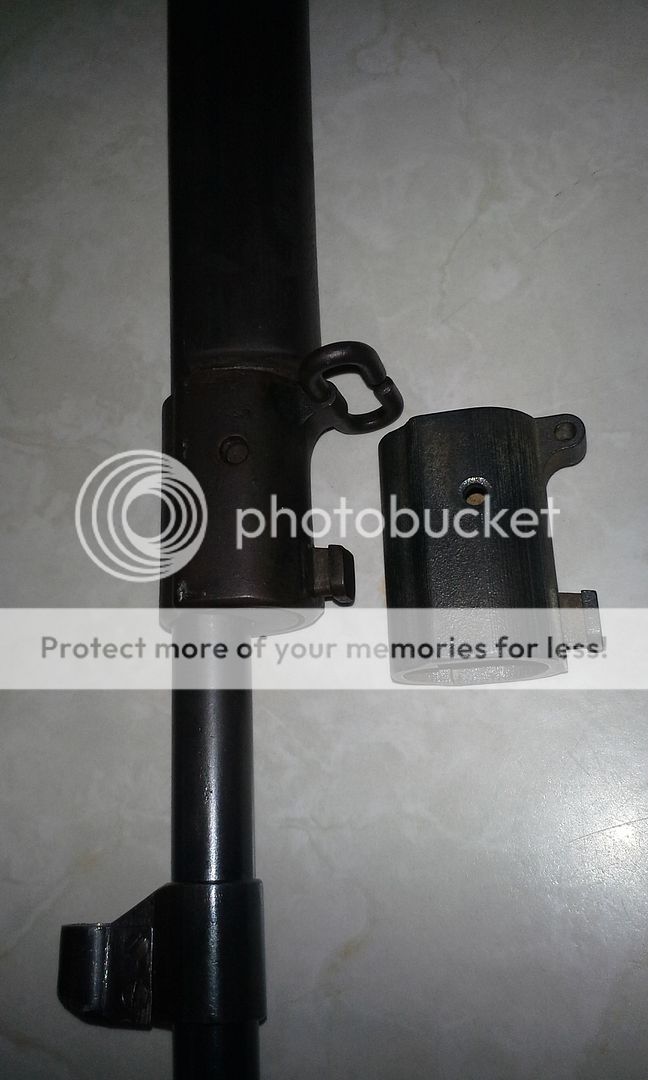

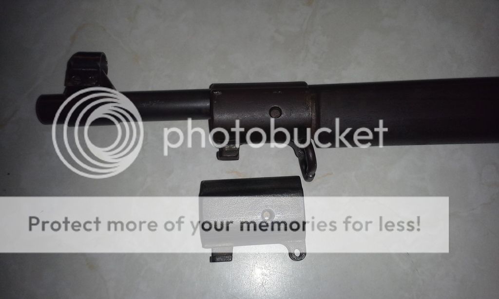

I've taken an original late style forged MK III nosecap and created an auto CAD file that can be printed on a 3D printer. I've printed a few plastic ones which are handy to have especially when splicing in new fore ends. I've also had a metal one printed.
You can buy the metal one from this link;
http://shpws.me/LBZP
If you go to the Ross Rifle Forum and search me up (Greg) you'll find a whole thread that shows more pictures and tells the whole story.
The metal band is expensive (approx $125 U.S.) but the plastic one is cheap ($25 Can).

Yes they charge $174 for the metal one that they print (apparently the price does fluctuate, it came down $5 over the last week). They are the only shop in North America offering this service right now. As for plastic, I can set you up with a plastic one that I printed locally for $25 shipped.
