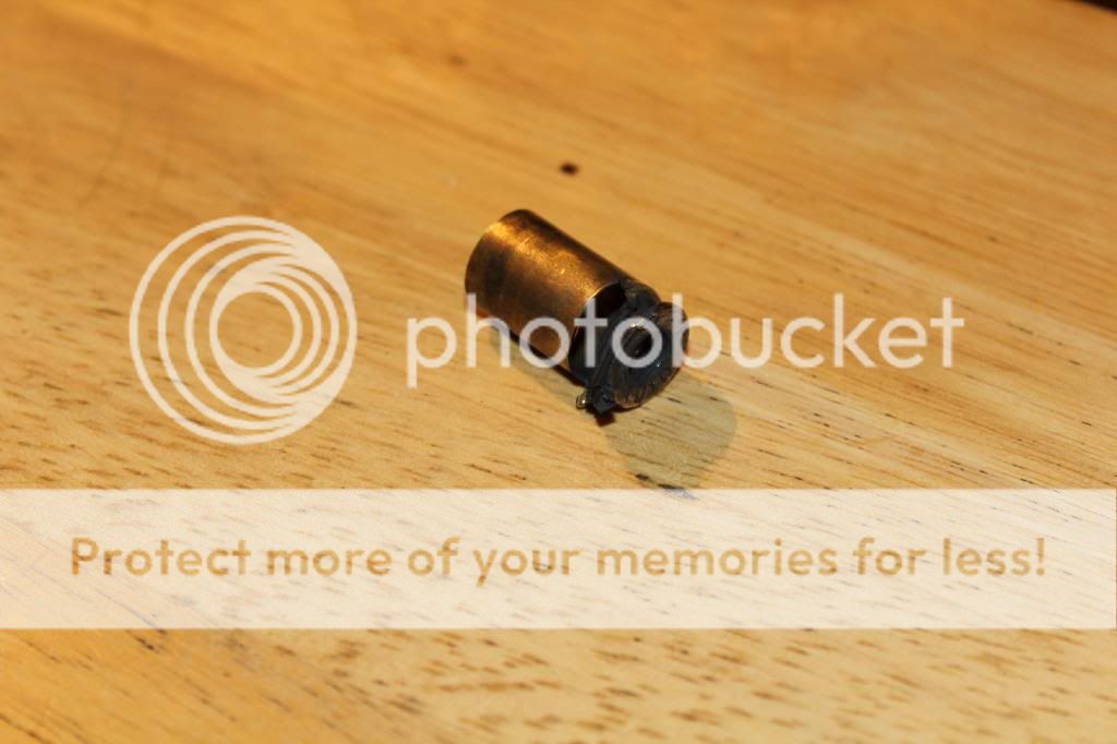

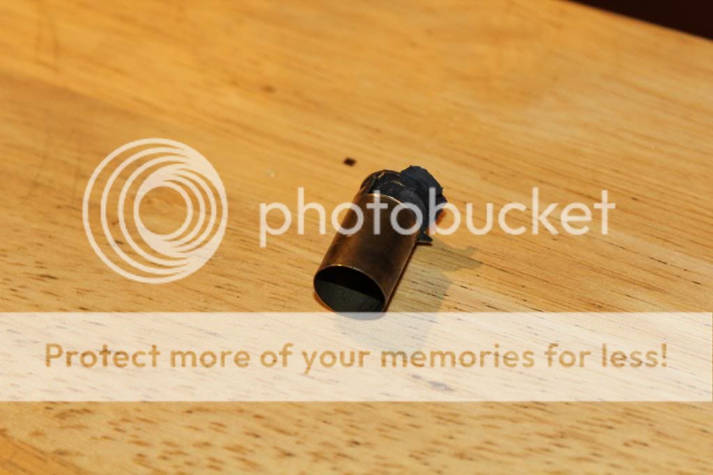

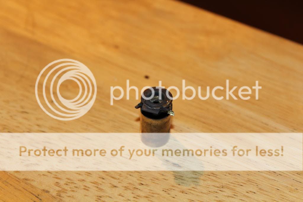

round went off in magazine 1911
split case
looks out of battery to me....should be more of the head covered then that by the feed ramp. Round seated too long, or working it's way out as you fired the mag due to not enough crimp...?
any cases i have seen split is at the top of the case. I have never seen one split at the bottom. I think there was too much powder in that one. I will dig up a similar picture of a KB with me, and an out of battery discharge. 10mm, Auto Ordanance

yeah she still doesnt feel the same. still have no feeling int he baby finger. Slowly coming back, but still hurts if you touch it. Has been a few years now. The missing parts of banana'd brass went into my finger, and some of it they didnt find till a few days later when they did an xray because it hurt so much still. This was a round that got stuck on my buddy firing, and him being new, i grabbed the gun and tried to free it.
I couldnt get the slide to move from the back, and so i grabbed the top of the slide (dont do this) to try to get more leverage. As i pulled back on the slide it went off.
