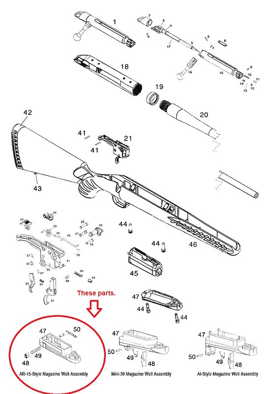

For those that do not know, the ruger American particularly the "ranch" version has magazine conversion kits. Your options are
-Proprietary ruger plastic mag
-Ar15 mag
-AICS Mag
-mini30 mag.
So for CGN I give you the mag conversion guide.
conversion kits are $19 USD direct from ruger, and they ship to canada, I confirmed this as of 17 aug 2021, you do need to provide your serial number to order the part.
First question: is my ruger american compatible?
answer: Every rifle will take the kit, even those that cannot feed off them. to determine if your rifle will feed off the mag you can start with the serial number
If the serial number has a dash in it... sorry about your luck,your gun is incompatible.
Anything with the first 4 numbers 6902 or higher (6903, 6904 etc) should be compatible.
But to be sure regardless of serial number you have to check the bolt to be 100%sure.
The bolt needs to be scalloped (as indicated with the red circle vs the older bolts) to be able to use magazines other then the floor plate or proprietary plastic ones.
After that the biggest choice is choosing what mags you want to use.
The only land mine in this is for the .450 bushmaster. yes you can use Ar15 magazines but you need a different follower. fear not they are commonly available on Ebay and the like for a few bucks as they are 3d printed regularly. And for those with a 3d printer its even easier.
I will post installation videos of my own when mine arrive
for now this one will do
-Ar15 mag
-AICS Mag
-mini30 mag.
